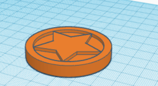

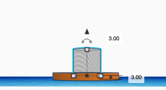

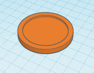

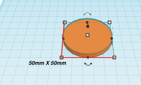

To make the base, start with a cylinder that's 50 * 50 mm and 5 mm tall. I recommend smoothing out the round edge by increasing the "sides" slider to 64. To create the indentation, add a "hole" cylinder and raise it 3 mm. Set the size to 42 x 42 mm and align it with the center of the base.
Step 2: Extra Details
So now you've got a blank half of a checkers piece. It's progress!

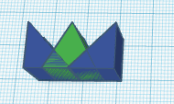

Now, duplicate and move a second base so you have two halves. You're free to decorate them however you like, but I recommend making both sides different so you have one to flip to when the piece is "kinged." I made the regular gameplay side a star, and made a crown by grouping two wedges and a triangle for the king side. Both of these were grouped to a blank side, as shown above.

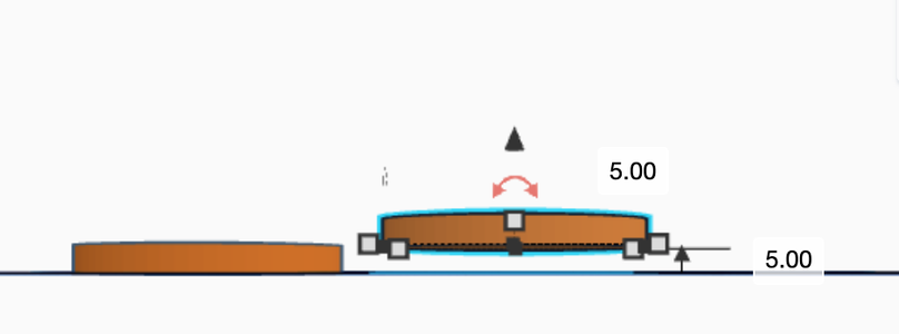

• Lift one half up 5 mm, or the height of your checkers piece.

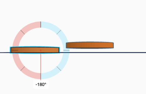

• Flip the other half 180° upside-down and move it beneath the raised piece.

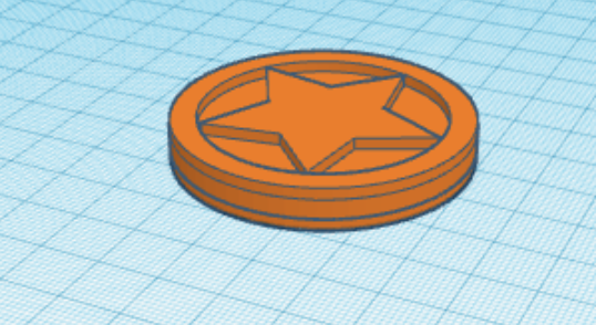

• Lower the raised piece 2-3 mm, or until the piece is the thickness you'd like.
• Group them together for easier rescaling, if needed.
Now you've got a two-sided little checkers piece! If you're ready to print out a set, I recommend duplicating the piece until you have the amount desired for the set. Happy gaming!
