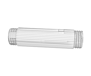

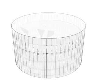

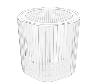

Step 1: Printing the Parts
Attached are the .stl files for all printable components.
While printing, I used a standard quality print with a 15% fill.

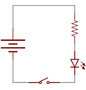

Step 2: Circuit Assembly

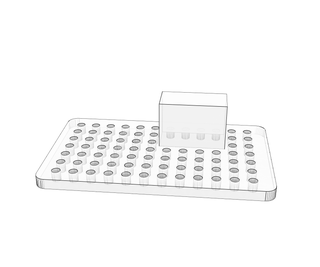

Dimensions of the perf board are 20mm x 32mm.
The positive wire is 8cm long and the negative wire is 6.5cm long.
Using the circuit assembly pictured, solder the components into place. Remember to make sure that your diode is face the correct direction! (the flat spot on a diode indicates the cathode or negative side)
**The blue block is just a piece of plastic I found and glued to the board to provide support for the push button.
