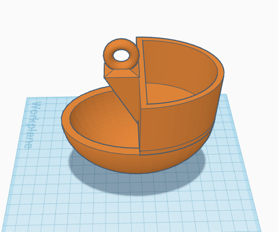

These 3D-printable planters were designed to be used as single planters, or locked together to create larger planters with multiple sections. These planters were designed in Tinkercad with snaps that can be pushed together to connect firmly. There are three different designs for the planter, one with no drainage holes on the bottom, one with small drainage holes, and one with larger drainage holes. Each planter has three rings on it to allow it to be hung with hooks or strings.

STL stands for Standard Triangle Language, and it is the type of file often used for 3D models. Select the file you need(no drainage holes, small drainage holes, or large drainage holes), and download it. All of the planter files are the same size, so you can download several and interlock planters with varying drainage holes.
