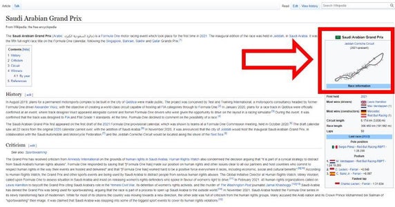

First things first we need an svg of the track - svgs are great as they're very easy to work with and you don't have any issues with the edges burring etc when enlarging the image.
Fortunately Wikipedia is a great source for these so that's a good place to start your search - where your track is available, we can simply click on the image then just download that as shown in the pics above where I download the svg for the Jeddah Street Circuit.
If you get unlucky and yours doesn't have a Wikipedia page or the Wikipedia page doesn't use an svg, try searching google images and hopefully you'll find one there.
If the absolute worst comes to the worst, you can find a high resolution image of another type and convert it to an svg using an online tool like convertio though you'll need to edit the image to remove any details you don't want included in your print before you convert to svg in this case!

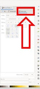

  • You'll then need to switch to the 'Stroke-Style' tab within that panel as shown in pic 3

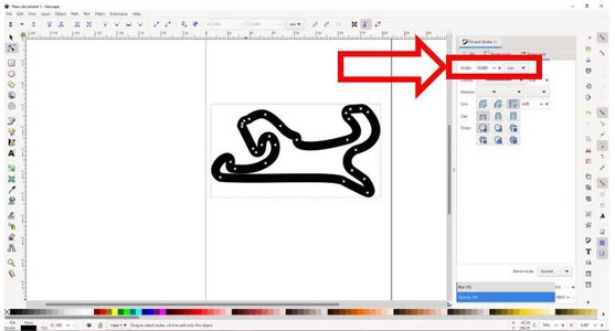

  • To thicken the track you can now just adjust the width value as you wish - I set mine to 10mm as shown in pic 4

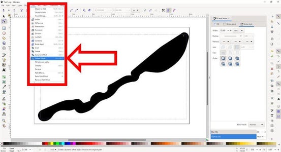

  • From the Path menu in the menu bar at the top of your window, select linked offset (as shown in pic 2)

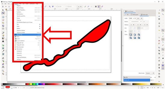

  • With the track still selected, choose any other colour from the colour picker at the bottom of the window - this is only to help us distinguish between shapes so it doesn't matter which you pick - I'm using red! It should now look like pic 3
  • Still keeping the now coloured section selected, from the top menu bar, open the Object menu and select 'Raise to Top' - as shown in pic 4

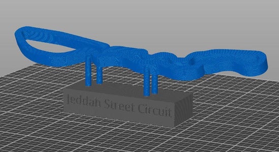

  • Once imported your svg should appear as a 3D shape as shown in pic 3
  • it will have a thickness of 10mm by default but you can change the dimension across any axes by selecting your shape then clicking and dragging the white boxes
  • To scale the whole shape uniformly, hold shift as you click and drag one of the boxes!
  • Now, you can make any modifications you wish at this point (I've created a stand for mine!) or you can just simply export it as an stl as is - you'll find the export button next to the import one we used earlier and it's also shown in pic 4
