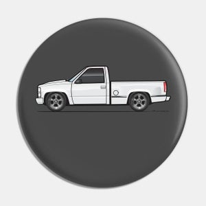

My first problem was not being able to find any reference images or blueprints or any way of starting my drawing process. But I kept searching and I found this sticker to use as a reference

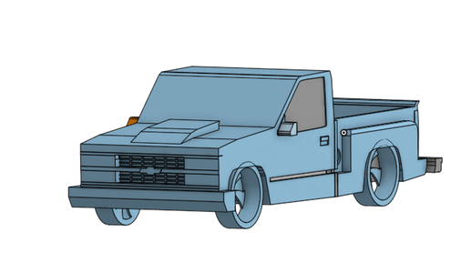

So for this step, you need to put in your reference photo on one sketch of the face you want to draw on then you need to make another sketch on that same face to start tracing over your object
Step 4: Extruding/Making It 3D
Once you have your image fully traced out you will have to select all the pieces you want a certain with and extrude them all as one but make sure to have, Symettric selected.
Step 5: Detailing
After you have extruded you will go back and trace over any detail and extrude it to a measurement that's .05 or larger depending on what it is you need to extrude.
Step 6: Finished Product
After adding all of your detail and miscellaneous stuff you can go ahead and save it as a STL file and export it to your 3D printer and print it out.
