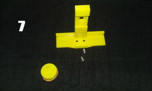

  6. Now join the HolderBase to the ConnectorBase using the 5x5 screws in the holes in them. If you want, add some glue to be extra sure.(Pictures 7 & 8)

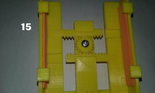

  11. Put the gear in the hole of the HolderBody, so that it gets into position betwen the RailGears, making sure both clamps are at the same distance. Push it until it enters into the round notch around the hole. (Picture 15)
