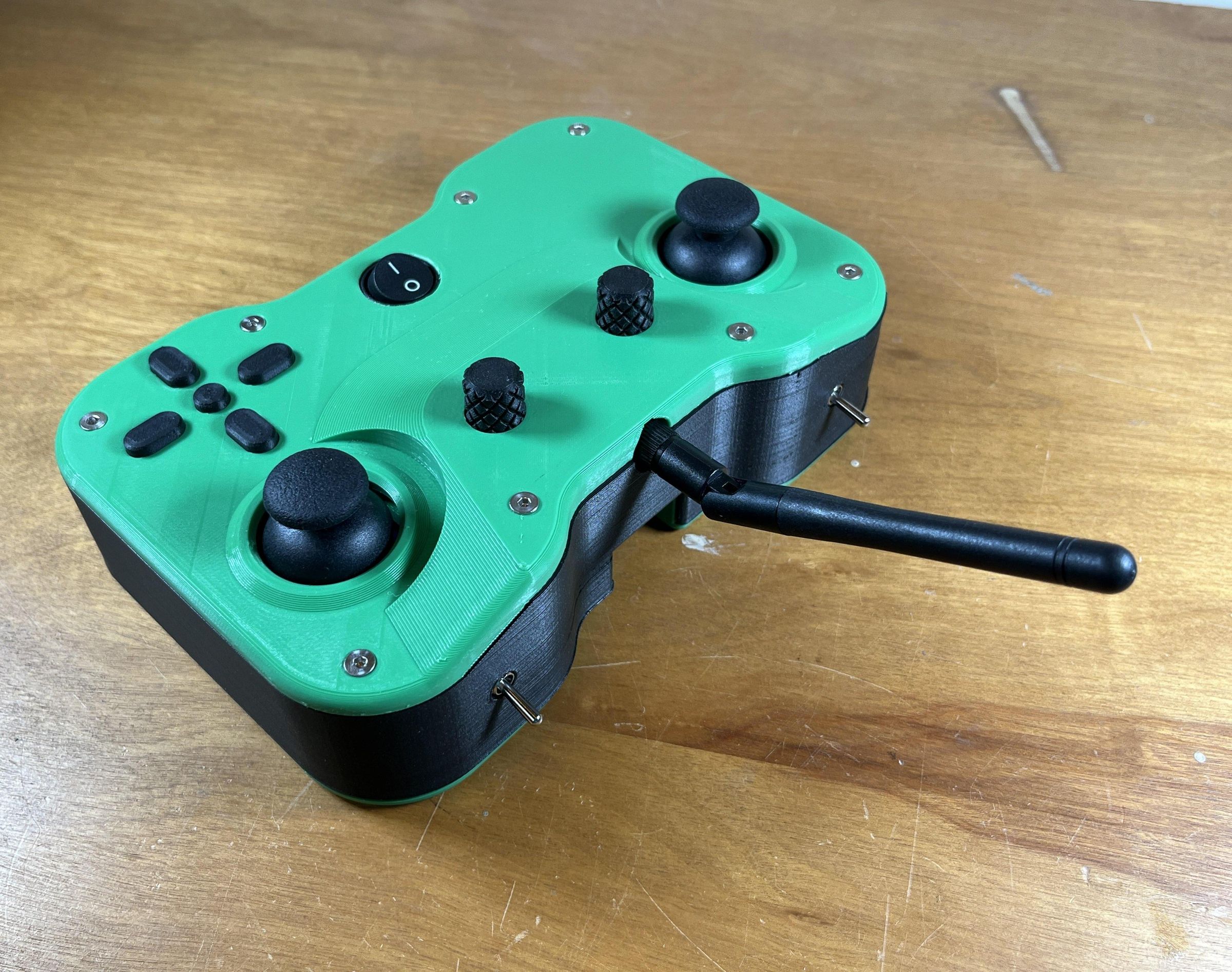

Step 1: 3D Model
I began by modeling the controller in a 3D modeling software. There were a few things I took into consideration during the design process:
- My 3D printer is relatively small, so my parts would need to be joined after the printing process. To solve this, I added holes throughout the design to attach parts using m2 screws.
- I wanted to easily rearrange parts on my design without having to re-print, so I added uniformly spaced holes where the parts would be joined to allow for post-print design opportunities.
- I avoided overhangs altogether in this design, resulting in high-quality prints.
This model doesn't contain all of the parts that make up the transmitter, but all of the parts required to 3D print are included. You can download the STEP file for this model by clicking download below.
*I included the .stl file for the nrf24 enclosure for those who were having trouble splitting it into three separate parts.

Step 22: Arduino Connections
Choosing this design of transmitter results in a seemingly disorganized underside. To make this seem like a less overwhelming task, I focused on one type of connection at a time. For example, I began by connecting all of the GND wires to the extended row for GND on the perf board. Here are the connections:
Digital Pins:
D4 - Joystick1 Sw
D5 - Joystick2 Sw
D6 - Outside pin of 2 Position Toggle Switch
D7 - Outside pin of 3 Position Toggle Switch
D8 - Other Outside Pin of 3 Position Toggle Switch
D9 - CE Pin of NRF24L01
D10 - CSN Pin of NRF24L01
D11 - MOSI Pin of NRF24L01
D12 - MISC Pin of NRF24L01
D13 - SCK Pin of NRF24L01
*Note: This is when color coding your wires will come in handy. The NRF24L01 enclosure restricts your view of the pin names. When you color code the wires, you can tell which pin is which without much effort, making it much easier to connect the wires to the Arduino.
Analog pins:
A0 - Center Pin of Potentiometer 1
A1 - Center Pin of Potentiometer 2
A2 - Joystick2 VRX Pin
A3 - Joystick2 VRY Pin
A4 - OLED SDA (DATA) Pin
A5 - OLED SCL (CLOCK) Pin
A6 - Joystick1 VRY Pin
A7 - Joystick1 VRX Pin
Voltage Regulator (AMS1117):
Connect the ground pin of the NRF24L01 module to the ground pin on the voltage regulator. Connect the 3.3 volt pin on the NRF24L01 to the voltage regulator.
Ground Pin Extension Pin Headers (Connect all of these pins to the ground pin headers):
- Center Pin on 2 Position Toggle switch
- Center Pin on 3 Position Toggle switch
- Joystick1 GND Pin
- Joystick2 GND Pin
- Potentiometer 1 right pin
- Potentiometer 2 right pin
- OLED GND Pin
- GND of Battery Case
- GND Pin on voltage regulator
5v Pin Extension Pin Headers (Connect all of these pins to the VCC pin headers):
- Joystick1 5v pin
- Joystick2 5v pin
- Potentiometer 1 left pin
- Potentiometer 2 left pin
- OLED VCC pin
- VCC Pin on voltage regulator
Other Connections:
The final component to connect is the on-off switch. One lead of the switch should be connected to the positive terminal on the battery case. The center pin will be connected to the VIN pin on the Arduino.

You can control virtually any Arduino project with this controller, and the its design allows for even more modification. You might decide you want two additional potentiometers instead of an OLED Display (If you would like the STEP file of a 4 potentiometer rack, I can send that to you. Just make a comment with the request). Or maybe you wish to add a few push buttons to the design. It is entirely up to you.
If you have any questions, comments, or concerns, don't hesitate to ask.
Thank you for taking the time to read through these 24 steps. I hope you were able to learn something or get a few new ideas about what can be accomplished with a 3D printer and an Arduino.
