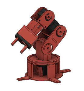

Step 5: The Design Process: the Final Robotic Arm
The final version of this arm looks slightly different then the previous two versions. I originally switched out the second servo for a high torque servo, but I ran into the problem of having to transition from a high torque servo (wider) to a micro servo (not as wide) in a bar. I couldn't seem to work out how that was going to work without it being ugly, so I just rooted the bottom servo to the ground, keeping the transition in the servo enclosure arm.
Step 6: Assembly: Print the Parts
I have grouped this arm into 5 sections:
- Base
- Axis 1
- Axis 2
- Axis 3
- Gripper
Each STL file name corresponds with the location of the part on the arm. For example, "base - support" would be a supporting piece in the "base" assembly.
I have included the .step file for this design for those who wish to view it.
To download the .stl files, visit this link.
