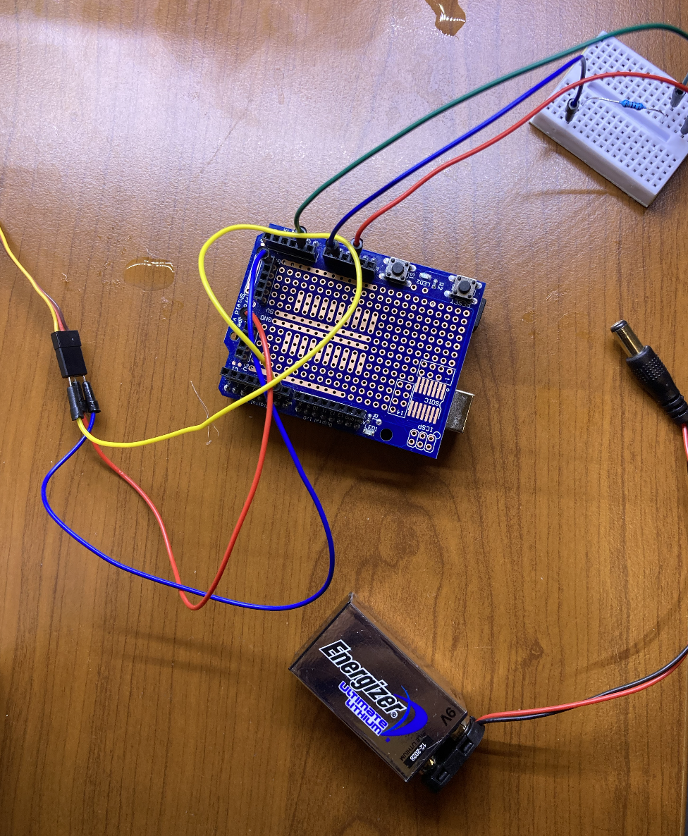

Step 2: Arduino

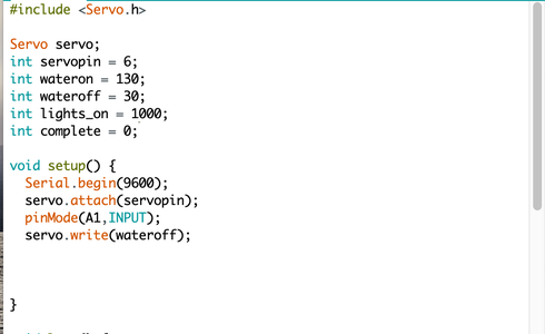

To water the plants, I'm using an Arduino. It uses a repetitive piece of code that checks the amount of light on the plants and actuates a servo if the conditions are met.
The condition for the light is whether the amount of light falls below a certain threshold, which indicates to the Arduino that the lights on the hydroponic setup are off for one of the two breaks during the day.
When the lights are off, the board tells a servo to turn to a specific angle, which opens a special 3D printed valve and lets water flow from the water bottle to the plant using gravity. The details of the parts and water tubes are shown in the next step, after this code breakdown:
  1. Code establishes the servo and specific values that indicate angle values and light levels for reference
  2. Code sets the valve to closed (just to be safe)
  3. Code gets a measurement from the photoresistor, giving us light level
  4. If the light level is less than the threshold, initiate the watering process
  5. If it's greater than or equal to the threshold, do nothing
Throughout the code, you will see the use of the variable 'complete'. I used this to make sure the system doesn't water the plants every time it measures the light (every second) when the lights are off. That would turn into a watery mess. The watering process is completed the first time it runs through the loop, but it assigns the value complete to an arbitrary value greater than 0. The next time it goes through the loop, it is redirected such that it doesn't do anything. Turning on the lights resets the complete value, so the plants get watered in the second light break as well.

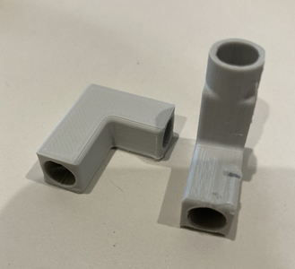

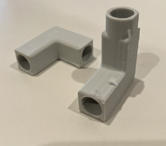

Step 3: 3D Printed Parts & Water Tubes!
Turning a servo doesn't move water, so I had to create something that would move the water from the bottle to the plants. Drinking straws were a good option, so I used those as the 'pipes'. However, I couldn't bend the straw to change its direction, as it would kink. More importantly, I couldn't turn off the water flow using just straws.
This meant I had to get creative. I needed to design parts that would fit around the straws and control the water.

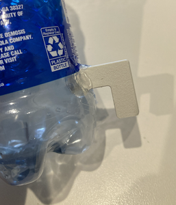

To solve the straw-bending problem, I used CAD to create an 'L-Joint' that I could plug into the side of a bottle as well as another L-Joint that just connected two straws.

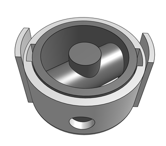

Step 4: Water Valve
The water flow problem was a different issue altogether, warranting its own section.
I originally tried using the servo to pinch the straw and stop the flow. However, it did not stop the water fully, so I designed a new mechanism, which I call a 'rotary valve'.
This valve uses a servo to turn a small section of pipe to an angle, disconnecting the flow of water and blocking water from moving. The images show its function clearly.
To control it, I created a flat mounting point for a servo arm.
The tolerance between the inner rotating part and the outer housing was 0.025 in, which translated well into the real thing. I put grease in between the two to make the gap watertight.
I mounted the servo arm to the inner disc and mounted the servo itself to the outer disc. It worked very well.

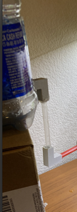

Step 5: Final Assembly
Now the three systems would come together.
I took the rotary valve and plugged the servo into the Arduino, and I connected the tubes for the water to the valve. I put the output end of the system at the base of one of the plants.
I experienced many issues in getting it to work, and it still isn't a perfect system. When I turned it on, I got to see exactly where I didn't put enough glue when the water leaked out from a couple of spots. The valve also experienced some slow leakage. After a generous amount of glue and grease, the system was working and the valve was dripping very slowly, nothing that a cup under it couldn't fix.
