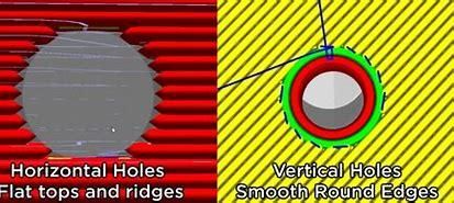

When printing holes vertically, the resolution and quality of the holes are worse than printing them horizontally. This is because 3D printing happens in layers. Essentially, a 3D printer has to print one layer, and then it puts another layer on top of that one to make a creation. The thickness of these layers is called layer height. A higher layer height (0.4 mm) takes less time because the 3D printer has to put less layers while a lower layer height takes longer because it has to print more layers (e.g if your printing something 1.6 millimeters tall, a layer height of 0.4 would mean you need just 4 layers while a layer height of 0.1 would mean the 3D printer would have to apply 16 layers). On the flip side, layers with a lower layer height have a finer resolution. If a 3D printer has to make a hole through multiple layers of different lengths as opposed to just drawing a hole at the bottom and making multiple layers of that, then the resolution of the hole will be impacted. You can see this in the images provided.
Step 7: Why Have the Water Reservoir Divider As a Different Print, Continued
Another reason why you wouldn't want to print circles vertically is because of bridging. Bridging is essentially when a 3D printer has to print filament between the gap between 2 points, creating a bridge between both points hence the name. Bridging is something that most 3D printers struggle with to some degree, and while the high-end ones don't struggle as much, for the most precise circles its always best to print circles and holes horizontally. In the last 2 pictures you can see the difference between both. The top right image is printed vertically, while the bottom right is printed horizontally. Note the imperfections on the vertically printed one as compared to the horizontally printed one. Now all we have to do is print the part and start working on the project!

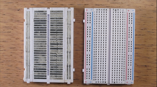

A breadboard is a device that allows people to quickly connect electronics together, and also lets them take them apart easily. The slots on the outside (marked light blue on the picture) are generally used for power, while the ones on the inside can only travel horizontally. Another way to understand it would be to look at the copper wires on the other side of the breadboard in the picture on the right, and how currents can only travel through those copper panels.
