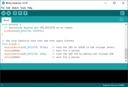

Step 4: Software
The program is based on a number of examples which are combined. berlinUhr.ino is the mainprogram. ntp.h is made from an Arduino example for time keeping using Wifi and NTP time servers. wifi.h is used to connect to the wireless network. display.h is used to display time with neopixel led's. easterEggs.h and lightShow.h are cosmetical modules. Every hour the clock shows a light animation. easterEggs show on certain dates (eastern) a diffenrent color scheme.
