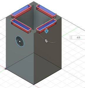

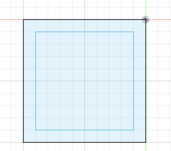

Create a sketch on the top surface of the box, and make a square with dimensions 5x5, 0.5" away from the edges, as shown in the image.

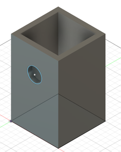

Extrude cut the inner square 8 inches down, leaving a hollow box.
Start a new sketch on one side of the box, and make a 1.5" circle with a center 7" from the bottom edge and 3" from each side edge. Extrude cut this circle -1".
