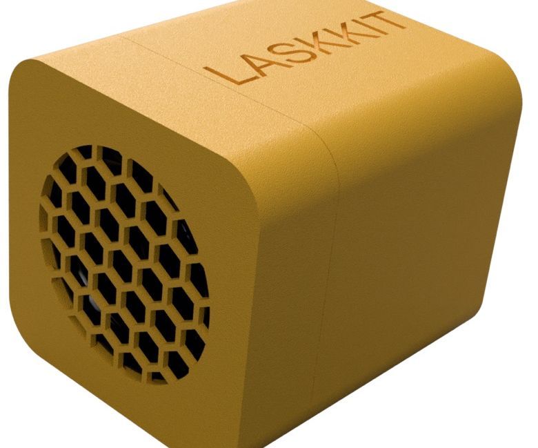

Hello everyone!
I’m going to show you to build clone of the most famous and the best sounding in the class Bose Soundlink mini. The last four months I been collecting information about this speaker, trying to find simple, cheap and good sounding hardware. Also, a lot of time took to design enclosure, printing samples. This project is open source, you can download enclosure and print it, all parts are widely available on Ebay or AliExpress.

3D printed enclosure:
Designed in Fusion 360, suppose to take together all component, almost without gluing. Printing in PLA 0,2mm layer about 15 hours.

Take drivers and solder wires with JST-XH-2 connectors, maybe you will need to make wires longer. Screw drivers to the face part of speaker like on picture. That’s it!
Connect amplifier with drivers and boost module, pay attention for left and right channels.
Step 6: Wiring and Mounting, Screw It!
Better if you try it now before screwing. Turn on the
speaker, take your phone and search for a Bluetooth device called "Xpecial Audio". Connect and try to play a song. Does it work? Great! We can continue!
Add passive radiator and screw back and face parts, switch on and try the perfect sound from your DIY speakers ;) .
