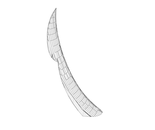

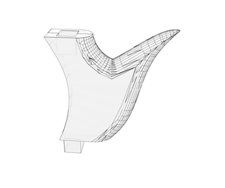

For this project I used solid works and tinkercad to design my bow. I made the overall shapes in solid works and separated them into printable parts in tinkercad. The overall size of the bow is around 125cm in height (my shoulder) but can be scaled down if need be.

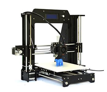

Now that the 3d models are done you need to put them into a 3d slicing software such as cura but you can use any slicer you want to. Here are some pictures of my settings for some quick prints ( my printer can’t really handle long prints) but you can change them to suit your printer. Almost all of my prints were done in halves to allow for short bursts of printing. The overall time it actually took me to print all the parts was under 30 hours at 40mm/s.
The pictures above show my print settings for the halves and the handle which was printed whole. To print the other side all you do is rotate the model 180 degrees and your good to go.

The prints are finished and now need to be grouped into the top and bottom sections. To make this easier I have split the parts asymmetrically so the parts will only fit to their sides correctly. This makes it easier for sanding as you can test fit the pieces without looking around for the correct parts :)
