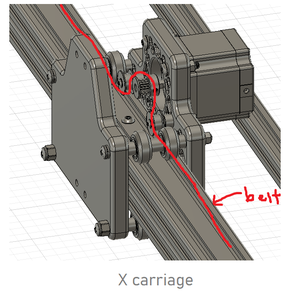

The system I used however is kind of the opposite. The carriages are slotted on the grooves of the aluminium profiles, secured by sets of rollers which allow linear motion along the profiles. The carriages move when the stepper motors turn and move along the fixed pulley. This system makes it possible to build the carriages in one single piece and slide it into the profiles, which means u can extend the profiles as far as you want (theoretically). This same system is used to move the cutting spindle in X and Y axis. The build volume is about 875*875*80mm.
Almost forgot to mention that you also need eccentric nuts to make sure the v shape wheels grip properly onto the profiles, and the idler pulley to ensure the belt is properly tensioned.
The Y-axis profiles sit on the ground, the Y carriage is installed on it, and then the X carriage is installed on the X-axis profiles which sit on top of the Y carriage.

There are definitely improvements that can be made to this project. I found that the Z-carriage is constantly twisting about the X-axis while plunging into harder materials. This is caused by the bend of the 3D printed X carriage, together with the tolerances of the v wheels (both on the Z and X axis). Maybe having a shorter X-axis profile, using linear rails instead of v-wheels would help in resolving this problem?
Another problem is the 3D-printed collar nut that keeps the Z carriage in place also breaks constantly, the plunging force from the spindle pushes the lead screw nuts upwards, which exerted force on the collar nut causing it to break.
