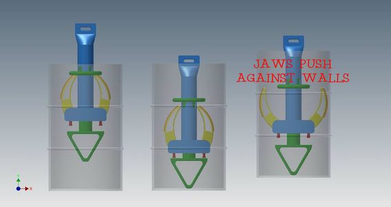

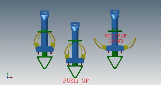

The Jaws (YELLOW) are initially folded up to prevent getting caught during transit and also allows the assembly to be deployed in small spaces.

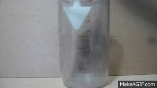

When the assembly is lowered onto a hard surface, the Inner Shaft (GREEN) slides up, releasing the Jaws to be used as a hook.
While the Jaws are designed to rotate open by gravity alone, there are Posts (RED) for attaching springs or elastic bands which actively deploy the Jaws like a rock climber's cam to pick up objects by pushing against the inside walls.
