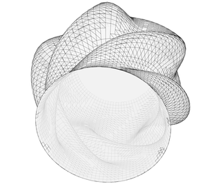

Step 1: Prepare the 3D Printing Files
First of all, whatever software you use to create your design, make sure you save the final design as an .stl file. STL file stands for stereolithography - a standard extension for any 3D software and will allow you flexibility should you make any changes last minute. MakerBot is most widely available printer, so I'll focus on its settings. To adjust the settings for MakerBot use their desktop application. Since we are going to cast the candle later, we want the printed object to be as smooth as possible with as few artifacts as possible (because 3D printing is additive process that extrudes material in layers, you inevitably going to have tiny stripes, that will be imprinted in your mold). To reduce this texture artifact - make sure you print at the highest resolution (see picture). Double check that the temperature for extrusion is set to 230C. Another way to go around the stripes is to send it down after printing, but that would add unnecessary labor. To proceed, export (save) your file in .x3g format - that's the format that MakerBots work with (see pic). Now put this file on the SD card (makerBots don't use other forms of flash card devices) and you are ready to print the candle. Proceed with printing. My print only took about an hour.
