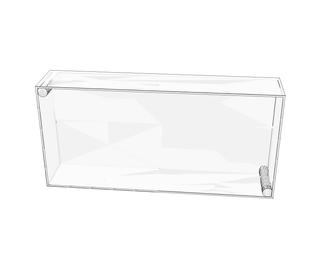

I've buyed a tester for mosfet and transistor. This is a simple tester that scan the piece connected on the three contact, and show on lcd the type and the scheme of electronic component. This good accessories don't have a case. I've designed and printed this case.
Step 1: Download the Stl File and Print
The first step is download the stl file and print it. If you don't have a 3D print, you can use the 3DHubs service. After this step is important add the connector to the 5 pins of connections. This step is necessary because the case is most high to use the simple connectors. See the photo.
