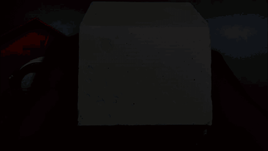

So this is my 3D Printed Cement Bluetooth Speaker!
Fun Facts, It's made out of cement and some custom 3D Printed parts.
This Cement Speaker is powered by a 3.7V 5.2Ah Li-ion Battery Pack and I used an old Bluetooth speaker Circuit to operate it.

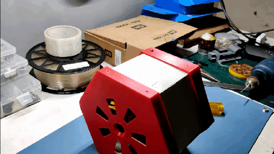

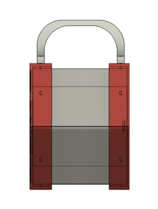

For Body, I first designed a Cement Hexagon Structure in Fusion 360. I made its Front and Backside from PLA, Front part Holds the Speaker and ON-OFF Switch in its place along with an Indication LED. The backside contains the charging Port. (STEP File is attached)
Also, Because I have used cement as the middle part of this Bluetooth speaker, it became quite heavy, around 2kg.
Anyways, After Finalizing this whole structure, I then 3D Printed the Front/Back Part with RED PLA at 20% Infill and Handle with transparent PLA at 10% Infill.
After this, I prepared the Cement Hex Structure by a Makeshift Mould that I made with Sunboard and Hot glue.

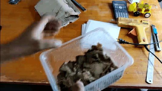

Preparing Cement Mix was easy, I took 600g of Cement and added 300g of sand to it. I slowly added a little bit of water to mix both of them together, we basically want pancake mixture concentration here.
To give the concrete little more strength, I prepared a cardboard paper mache solution which I later added to the cement mix. paper mache will act as a binding agent and it will increase the overall strength of this structure.
(for reinforcement of concrete)
At last, I added the cement mix to the mold and then let it set.
after 2 days, the cement has completely dried up so I removed it out of the mold (mold got destroyed in this process) and the result of this whole process came out just fine.

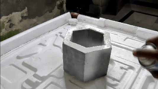

Step 3: Painting Process
For Painting the Cement Structure, I used white metal paint here but you could use cement paint here as well.
A trick to make this Cement Structure a little bit cooler is to use wood paints with wood varnish mixed.

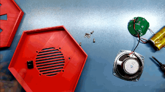

Assembly is pretty straightforward here,
I first added the Bluetooth speaker Circuit/Speaker setup to the front body.
The front Body holds the Speaker in its place, I then added a Rocker Switch (SPDT) on the front body and a 5mm indicator led.
On the Backside of the Back Body, I added a 5mm Barrel DC Jack for charging this whole structure.
For Wiring Connections, please see the attached Schematic/Wiring Plan.

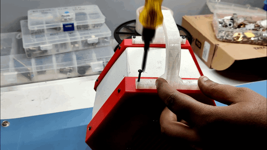

After Wring, Put the Circuit in between the Front and Back body and close the Lid from both sides.
Both Front and Back Bodies are secure with HEX Body by M2 Screws and Bolts.
Step 6: Results
After the assembly, all that is left to do is the final test, which is to play some loud stuff with this BT Speaker.
*Watch the video*
