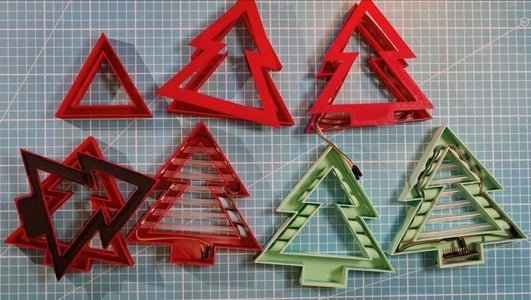

Step 1: Print the Christmas Tree
The christmas tree files can be found below. It consists of the tree and the lid to close it. They where generated using Open SCAD. This is a 3D Modeling tool using coding to generate models. The advantage of coding is that you can parameterize your prints i.e. you can change dimensions easily. I tried this, but it got a mess. So I don't add the SCAD file here since it is not needed and you probably get only confused. Nevertheless I learnt something in the process.
I had printed some iterations before I got to the final result. The main issue was light shining out at some places and through the walls of the print which wasn't what I wanted.
My print has some glitches on the outside, so I sanded it a little bit. Do this only when using a non glossy filament, otherwise it may give an uneven looking surface.

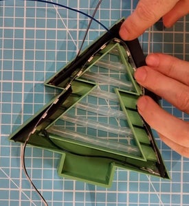

When everything works fine assemble everything. Start with the gluesticks since they are the most complicated part and you don't want to interfere with the electronics.
Cut the gluesticks to the sizes needed. When you cut them to the size of the visible part of the gluestick directly below it fits quite well. Then squeeze them in. You probably need to bend them a little bit.
When don't want to have the LEDs shine through the case, squeeze some black paper on the outside as shown in the picture. Also glue some black paper on the lid or paint it black.

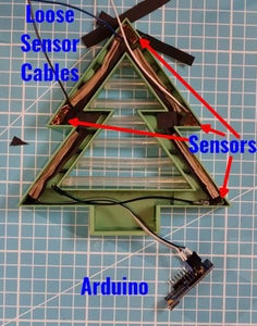

Fit the Sensors in, but leave the cables loose. be sure they have the correct length to go down to the base where the microcontroller will be placed.
Now fit the LED strip in. fit each LED to one of the tubes. There is one in the top middle which does not fit into a tube. This will not be used by the program and stays off.

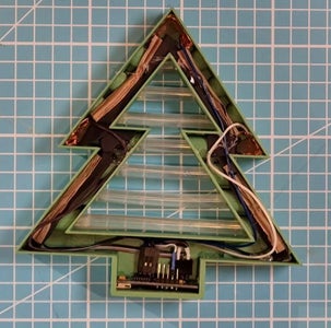

Close the lid. You may also do this later, but you don't need to do anything inside anymore.
Connect the Sensors and LED strip to the Arduino and put the Arduino in. Connect the USB to the computer and see if the LEDs shine corretly to the gluesticks.
