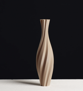

When thinking of ideas for this project I was really inspired by these marshmallow twists for some reason, and these 3D printed twist vases that I kept seeing. I wanted to combine both of these ideas into some sort of form for my chocolate casting.
