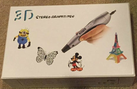

For a Soldering Iron I used: A 3D extruder pen. Mine is the Scribbler v3. There are many different types of these on the market, choose the one that suits your practical and financial needs well. Link to Product (3D Pen)Amazon Search for 3D pen (Contains Many Options)

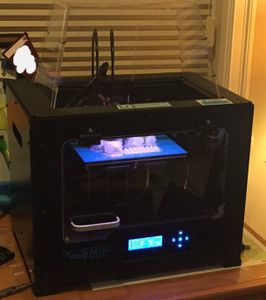

You need a 3D printer capable of printing with two different colors. This doesn't have to be a duel extruder printer, but it makes it much easier by having one. The printer I use is the FlashForge Creator Pro. It has been a great printer so far and I highly recommend it.

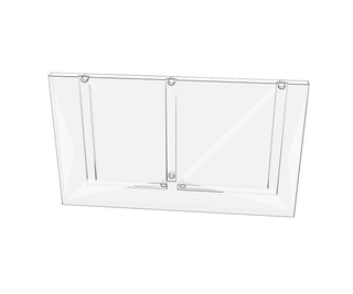

1. Create a box the size you want your circuit board to be. Then set its height to 4 mm. It should look something like the first image.
2. Measure out the maximum extension of your component leads. Make sure that your circuit board holes for that component are not too close together or too far apart.
3. Drag out more boxes and set their height to 1 mm. Make them as long as you want and place them slightly above your original box in the way you want them. These are your traces. Add cylindrical holes that have a diameter of 2 mm and a height of enough to stick through both sides of the traces where your component leads will go. Make sure everything you want connected is connected. You can remove the original box if it's getting in the way, just remember the dimensions.
4. Group all your traces together. You should know how to do this. DO NOT group the cylindrical holes with the traces. It should look something like the second image but you may have kept the box.
5. Add the original box back if you removed it.
6. Drag your grouped traces into the original box until the top is flush. If you used different colors (you should have), you will get a strange glitch effect as the two objects are on the same level inside each other. It should look a bit like the third image. If you don't see it at first, move the camera around, you'll see it.
7. Then, turn the grouped traces into a hole. Group the hole with the box.
8. Drag the cylindrical holes that were not grouped straight down without moving them to one side or the other. Then group all the holes with the box-trace group. It should look a bit like the fourth image.
9. Click "Design" in the upper left corner then click download for 3D printing. Choose STL, If you didn't rename the project it will save as a random name. Go into its folder and rename it to something you'll remember like "circuit_board_base".
10. Click Ungroup and delete the original box. If your cylindrical holes aren't long enough, extend them or move them so there are holes in the traces. Group the holes with the traces. It should look something like the fifth image. Then download for 3D printing as an STL file again. Make sure to rename it something you can remember like "circuit_board_traces."
