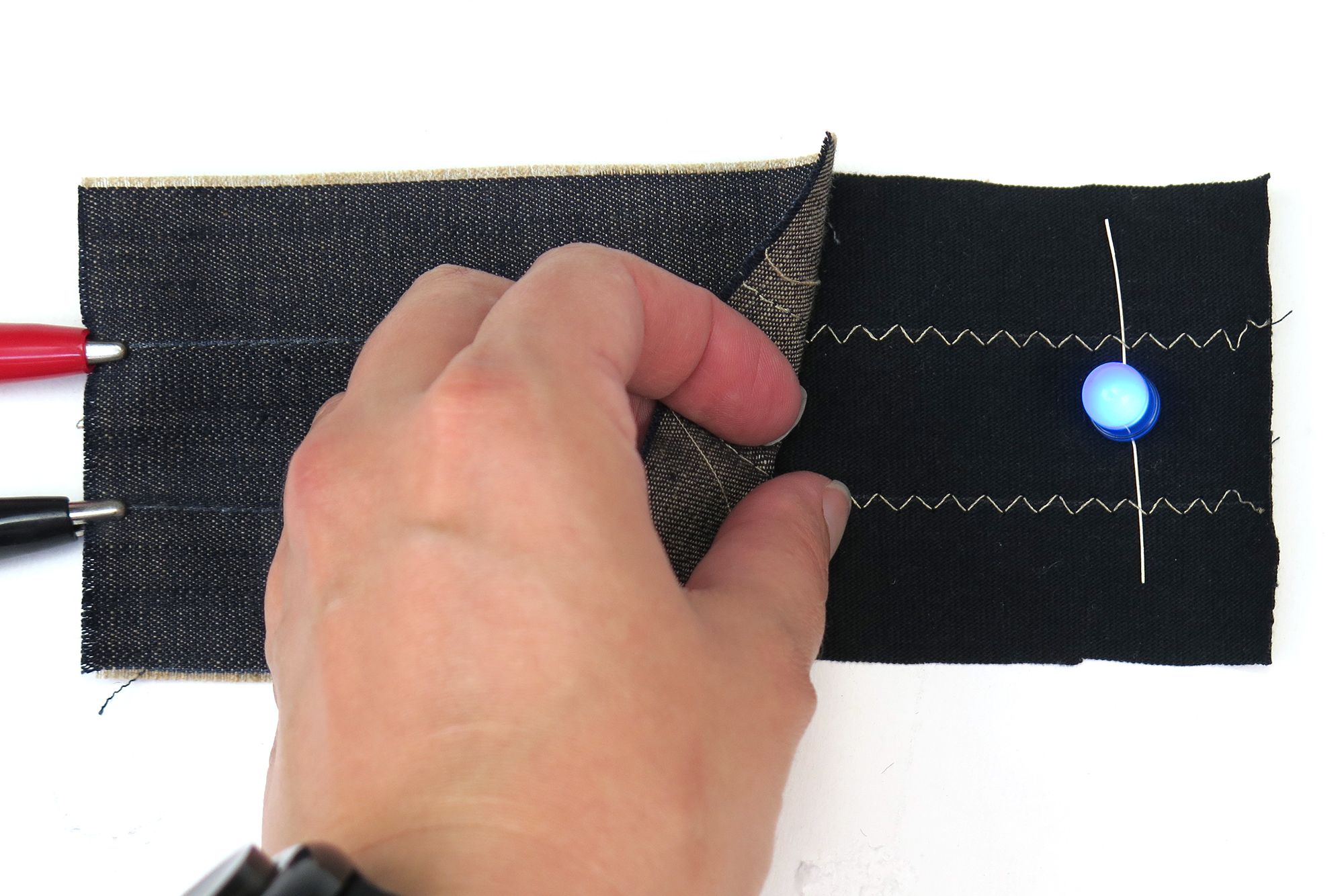

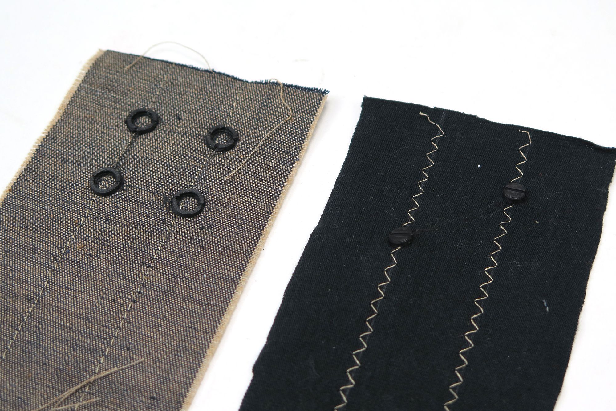

My swatch this year consists of two swatches. One is a woven cotton with a snap socket. the second is a knitted cotton with a printed post. Both are printed using conductive PLA on top of the conductive thread traces.

SocketSplit
This is what is photographed in this 'ible. It has two split designs to help the stiff PLA to flex around the stud. One design has two splits, the other has four.
StudSplit
Also photographed. Slit down the middle to help the stiff PLA flex while pressing into the socket.

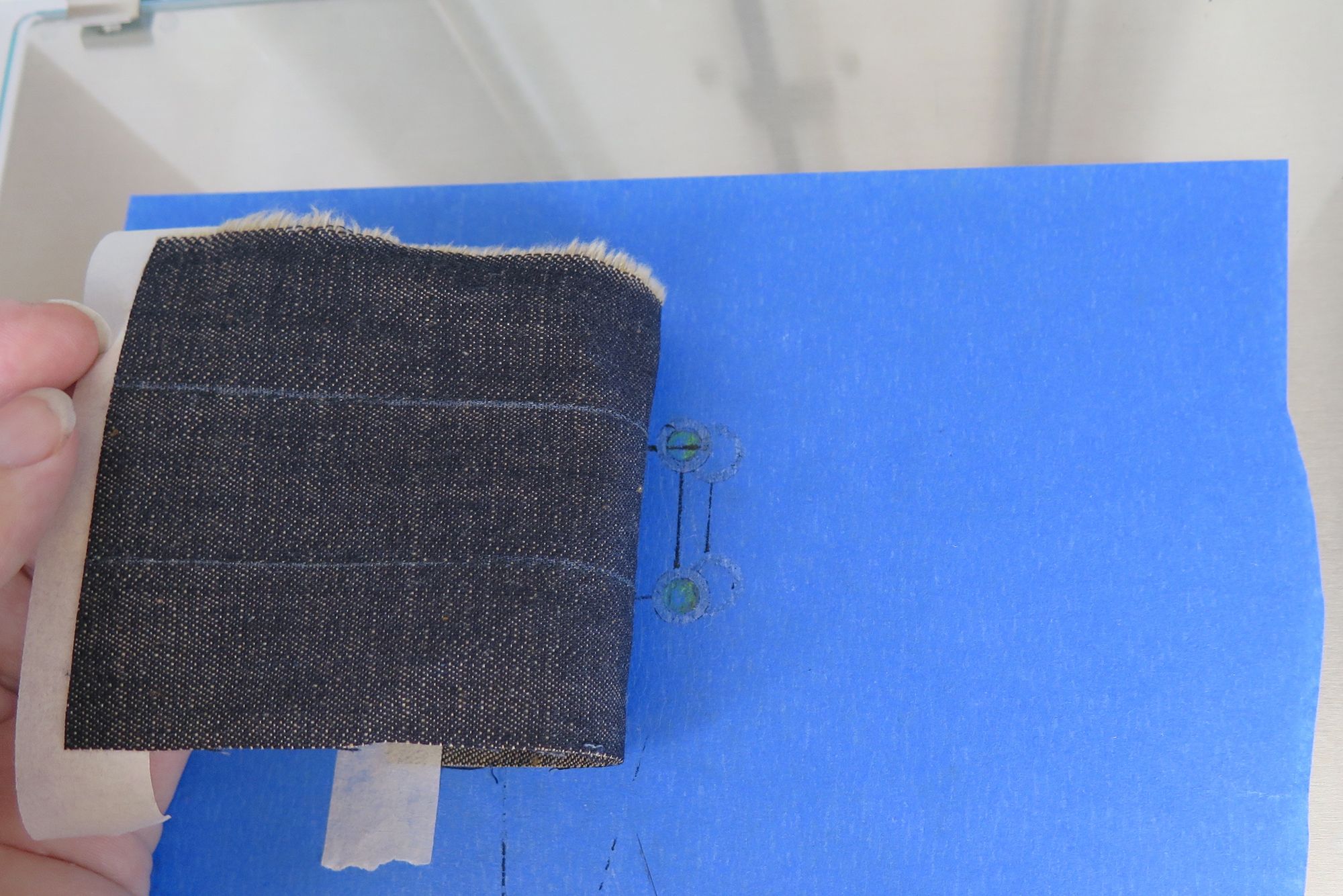

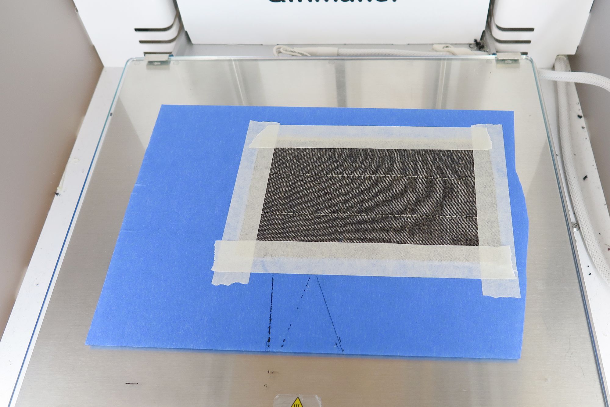

Mark
When the print in done take a pencil and mark where the print hits the blue tape.
Place
Put a piece of tape on one side of the fabric swatch. Line the stitch lines up with the centers of each mark and tape down. Proceed to tape down the rest of the edges pulling ever-so-slightly on the fabric to flatten it. For the print to bond with the fabric, the printer head needs to be very close to the fabric. So close, that it may drag across the fabric a bit. So, it's important that the fabric is held securely and taut.

My swatches do not show this step but it's an important one if you are making a project to wear or interact with! In my final photos, you can see that the traces of the two swatches face each other. If a ground and power touch that will create a short and cause the circuit to stop working or worse, like over heat. For a proof of concept, like these swatches, I didn't take the extra time to insulate the traces since the focus was the connector and I needed to make 25 of each side!
To learn more about how to insulate your traces check out my How to Work with Conductive Fabric 'ible and Sparkfun's round up of insulation techniques shown with thread.
