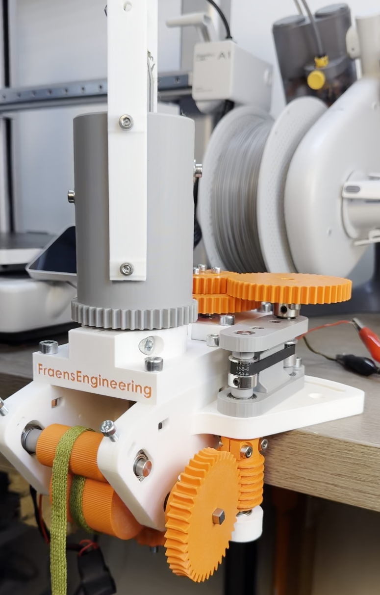

I have built a cord knitting machine that automatically knits cords from yarn. It uses special needles with a lockable flap and can be adjusted for different yarn thicknesses. All parts are 3D printable and individually adjustable.

Print the cam that lifts the needles with the lowest layer height possible. I have printed this with 0.08mm. It should also be printed from PETG. You can find the exact settings on my website.
Print all required parts and check that they fit correctly.

Yarn feed: To start, feed the yarn through a hole in the top of the machine. The yarn is then threaded around all the needles in a circle to prepare it for the knitting process.
Starting the machine: Once the yarn has been threaded around all the needles, you can start the machine. The yarn moves slowly around the needles and stable stitches are formed in the first round. If a perfect stitch is not yet formed, you can let the machine run for a few rounds to fine-tune it.
Step 3: Knitting Needle
Needle mechanism: The machine works with special latch needles (knitting needles with a lockable hook), which are guided over the needles by a rotating cam (lifting mechanism). This cam raises and lowers the needles precisely so that the stitches can form over the hooks of the needles. It may take a little practice at first to understand the mechanism, but with a little patience everything runs smoothly.
Step 4: Yarn Feed
Make sure that the yarn does not have too much tension, as this can lead to problems. An even and loose yarn flow ensures even stitches and a flawless knitting pattern.
Step 5: Stitch Formation
As soon as you have created a piece of cord, the pull-off mechanism ensures that the resulting material is transported evenly and without further intervention. The speed of the haul-off can be adjusted via the gear ratio. It is important to test this setting carefully so that the cord does not get caught on the needles.
Step 6: Using Different Needle
The machine offers a variety of needle guide mandrels that vary in number and diameter. For example, you can start with a 4-needle mandrel and gradually switch to a mandrel with more needles depending on the yarn thickness. Depending on the project and the desired result, you can also vary the number of needles to adapt the knitting process even better to your yarn.
Step 7: Creative Freedom
The cord knitting machine is extremely versatile and can be adapted to different yarn thicknesses and types. With the option to individually adjust the number of needles, the cord diameter and the pull-off mechanism speed, you can design every cord exactly how you want it - ideal for creative projects or DIY projects.
