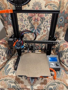

A 3d printer, I use the Ender 3

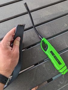

A lighter

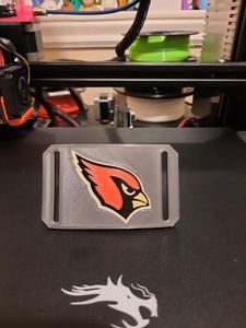

Step 1: Download/create the Files
I designed all of this using tinkercad, and I have made my designs all public on there so you can just download my designs at: https://www.tinkercad.com/things/lwwZuwv3XgV . You can also use the blank belt buckle to add your own design using an image to lithophane generator of which there are plenty but my favorite is: https://3dp.rocks/lithophane/
Step 2: Slice and Print
To make the multicolored belt buckles I print them flat and put in layer stops at the exact layer using Cura's pause at height setting and then changing the filament. If you want to print a plain belt buckle I would recommend just using one of the already curved buckle files.

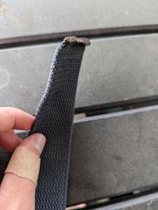

Step 4: Modifying the Belt Strap
This part is very important but not too difficult. The goal is to create a little lip that is big enough to stop the strap from being able to pull through the belt buckle. To do this I burned/melted the edge using a lighter and then pressed it against some parchment paper so it didn't stick.
