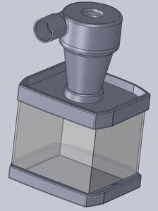

There are basically two types of ‘cyclones’ used for separators: Cone and Spool. Most commercial offerings are Cone designs, so I started there. Below is an early model that I made, which uses a Cone design.
This design would have probably worked fine as a separator, but I had a number of issues with it:
· It was tall! And the return hose back to the vac, coming out the top, would make it even taller.
· The bottom of the cone limited the tray space available on the top for tools.
· It raised the point where the hose would attach very high, making it more likely to tip over the vac over if I pulled on the hose very hard.
· And it was sort of ugly.
I settled on the Spool based design above, which isn’t quite as efficient a separator, but it’s a lot more compact and addressed all of the issues above. I couldn’t find any good separation efficiency comparisons between Cone and Spool based designs, but I suspect that that efficiency difference is not enough to worry about. The more important part is holding a good vacuum. You want to eliminate, or at least minimize any vacuum leaks. The spool design works very well. If you watch the video, I was almost able to fill the box in 30 seconds.

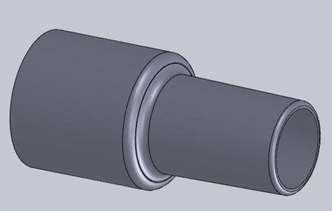

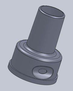

I also included two STL files for adapters for the Fein hose that designed when I first got the vac, which allow me to connect all my old Craftsman vac 1.25 inch ID attachments to it.

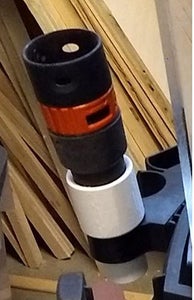

The first shows the Fein supplied hose adapter (black and orange) that includes an adjustable vent (orange) which allows you to reduce the vacuum. Attached to it is my Fein Hose adapter 1 (white and in the second figure), which slides onto the Fein adapter.
The Fein/Adapter 1 combination was rather bulky, and I never used the vent, so I designed the Fein Hose adapter 2 (3rd figure), which clips onto the end of the Fein hose, and replaces the two parts in the first figure.

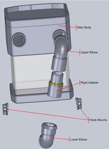

Step 2: Components
This images identifies the various components, and how they are assembled. The component names in the Figure match the prefixes of the associated STL file names.
The Dust Extractor consists of 5 major components: Main Body, Upper Elbow, Rigid Adapter, and the Hook Mounts.

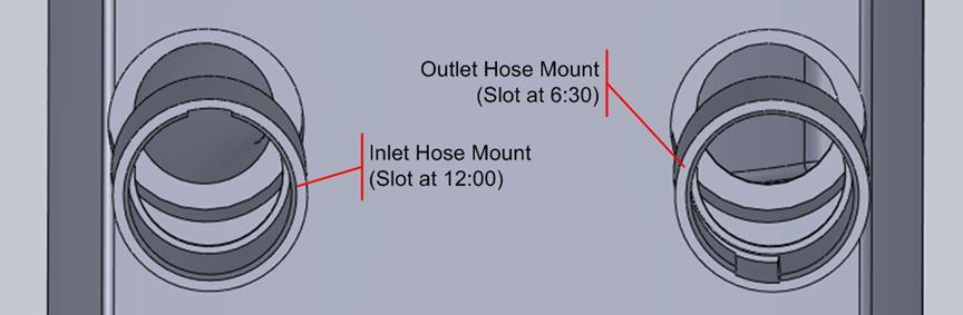

The hose that comes with the Fein uses a tab, which slips into a slot on the front of the vac, and is turned clockwise about 40 degrees to lock the hose in place. As much as possible I used the same interface to mount the hoses.
There are 2 Hose Mount parts on the front of the Top. The Inlet is on the left and the Outlet is on the right. The Hose Mounts are not integrated into the Top, so they can be redesigned if you want to use the separator with a different vac or hoses. Which means that they need to be glued in.
The Outlet Hose Mount orientation is important!
In the Fein, the slot that the tab on the hose slips into is on the top of the mount (12:00). I used the same orientation when I glued the Inlet Hose Mount to the Top, see the figure below.
When I designed the ‘Elbow’ part (Hose Coupling Rt Angle.STL) I oriented the tab so the elbow would face up when inserted into the Fein house mount. If I want to use the same part for the Upper Elbow Assembly and have the elbow point in the right direction when it is inserted into the Outlet Hose Mount, then then the slot in the Outlet Hose Mount must be spun around to about the 6:30 position before gluing it in.

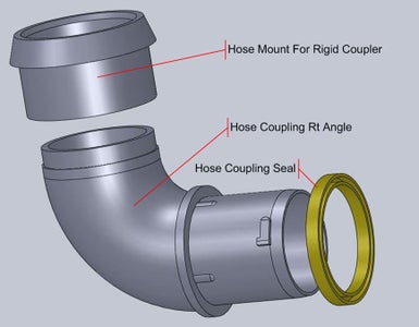

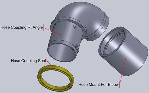

Step 10: Upper Elbow
The Upper Elbow uses the Fein style hose interface on both ends.
The Hose Coupling Seal was printed with TPU filament to make it flexible, and to seal the coupling. The seal does not need to be glued.
The orientation of the Hose Mount For Elbow slot doesn’t matter because the inter-connecting hose can rotate. Glue it to the Hose Coupling Rt Angle part.
I included a Hose Coupling Rt Angle.STL if you want print the elbow as a single part. But to avoid supports, I also include Hose Coupling Rt Angle a and b STL files, which can be glued together.
Step 11: Lower Elbow
The Lower Elbow uses the Fein style hose interface on one end, and a Rigid interface on the other. Again, the Hose Coupling Seal was printed with TPU filament to make it flexible, and to seal the coupling. The seal does not need to be glued.
I picked up a Rigid “Tug-A-Long” Dual Flex Locking Hose (part number LA2520) to connect the separator to the vac. It comes with a variety of adapters.
The orientation of the Hose Mount For Rigid Coupler doesn’t matter. Glue it to the Hose Coupling Rt Angle part.
Use the same Hose Coupling Rt Angle STLs for the Lower Elbow as the Upper Elbow, see above.

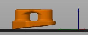

Note 1: I oriented the Hook Mount on the bed top optimize the surfaces of the part that were seen. See the figure. This resulted in wedge of support under the part, which was the side that attached to the vac, which no one would see.
