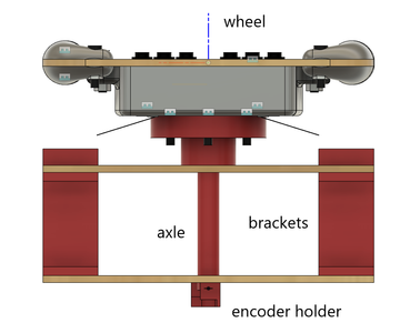

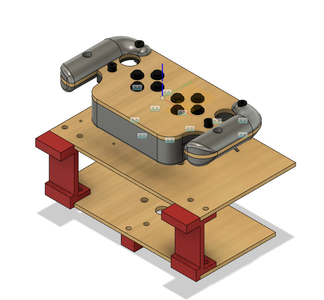

This design will consist of two main assemblies: the Steering Wheel and the Pedal Base. All assemblies were created in Fusion 360.
The wooden parts and the 3d printed parts have been distinguished clearly when designing, and have labels that will help with the identification of the parts, as some of them look quite similar.
The following parts have been created in CAD and added to their respective assemblies:
Steering Wheel:
Steering Wheel Handles
Steering Wheel Brackets
Steering Wheel Body

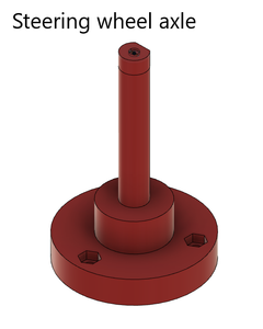

Axle
Potentiometer Holder
The top cover of the steering wheel
Support walls for the steering wheel (2 total)

Axle

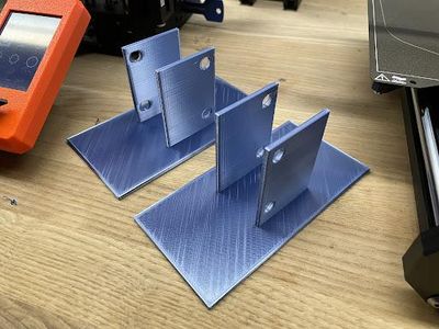

While it may seem like a lot, many of these parts are very small and take up a little printing material only. All these parts are printed in PETG, with a few exceptions. We recommend printing your test prints in PLA and your final prints in PETG. You can print these parts in the color of your choice, and make them as aesthetically pleasing as you like!
Here's a brief explanation of what each part will be used for.
Steering Wheel Prints
Steering Wheel Handles - These will attach to the top of the steering wheel body with a screw.
Steering Wheel Brackets - These brackets will be used to hold the two pieces of wood that hold the steering wheel up. For now, you can keep these aside.

Axle - The axle will be connected to our potentiometer and will help relay the input to the Arduino.

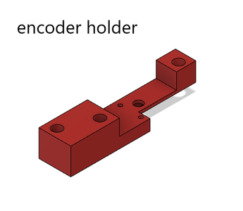

Potentiometer Holder - This will hold the potentiometer in place and will relay the input of the turning wheel.

Throttle and Brake Base - These will be attached to the base of your racing set-up and will hold the potentiometers and spring systems in place.
Potentiometer Holders - These will hold the potentiometers inside to ensure their stability and security.

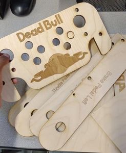

Step 3: Woodworking
This project also includes some woodworking. The required materials are:
Birch Plywood (12 x 24 inches) (1/4 inch thick)
Laser Cutter
*While a laser cutter is not required, we used one to cut our wood precisely without much waste. A circular saw and drill can still get the job done.
We will use the laser cutter to cut the following parts out of wood:
The base for both the brake and the throttle.
The top cover of the steering wheel.
The brake and the throttle (4 parts total)
The connectors for the brake and throttle to the potentiometers (2 total)
We customized our wheels with logos that we designed in Adoble Illustrator. We also attached the settings for our laser cutter above.

Then, attach the steering wheel top to the steering wheel box. The holes in the wood should line up with the holes on the box. Add the handles on top of the wood using the shape of the laser cut as your guide. Screw it until it's secure, but be sure not to overdo it or the filament can crack.
Next, screw the pillow block bearings on the insides of the front and back walls. The axle will go through here. Screw the base of the axle onto the back of the steering wheel box.
NOTE: The axle must be screwed in a way that the flat side at the end of the axle is the one on the bottom. This is to ensure that it lines up with the potentiometer.
Screw the two limit switches into the rectangular intrusions made inside the steering wheel box. Attach the Arduino to the back of the front wall. You do NOT need a Breadboard for this project.
Lastly, screw the potentiometer holder onto the back steering wheel wall. Place the potentiometer inside and make sure the hole is lined up with the axle. The potentiometer must start at the center position at rest, or else the steering wheel's inputs will be all off.

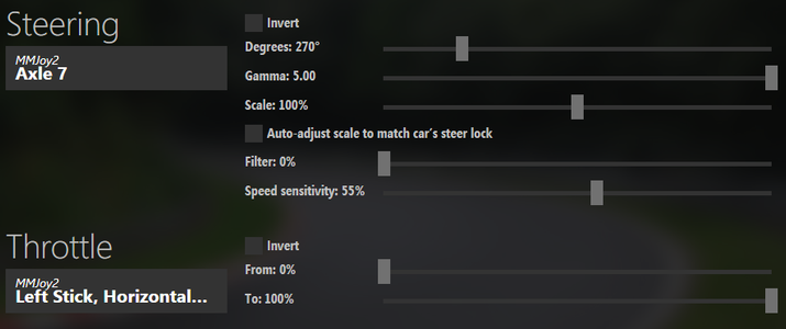

Download the MMjoy software. We recommend using the 2016 version as older versions sometimes have an error with inverting controls. Connect your set up to a Laptop/PC through USB. Following the pin setup given to you on the wiki, connect your buttons and axis to the MMjoy. I recommend watching this 20-minute video for more detailed and visual instructions. We will attach our layout below for your personal reference.
Step 6: Start Racing
Go to your Windows settings and select "Set up USB game controllers" to double-check that the input is being received. Once you're done this, open up your game and connect your controller.
For Assetto Corsa, specifically, we loaded the game through the Content Manager and selected all the bindings as the ones on our setup. If it is configured properly, this step takes only a minute or two. Each game will have different methods of connecting the controller, so what we did in this step may not apply to you.
Once your settings are finalized, take your car out for a test run! If something needs fixing, you can always recalibrate it in the settings. After adjusting them until they're perfect, you're ready to start!
