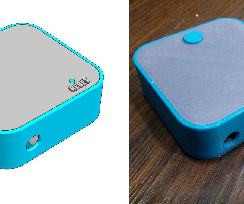

Step 1: Designing the Parts
There are a few considerations when designing in 3D for 3D printing.
  1. Figure out what the tolerance is for your printer. The Makerbot Replicator 2 and ExtraBot 3020 E3D (made in Thailand) we have used have about a 0.3mm tolerance -- meaning you have to leave 0.3mm along your edges to ensure things fit together. A 5mm peg will not easily fit into a 5mm hole. But if you do a 0.3mm offset, it will fit.
  2. Err on the side of caution: centrifuges spin very fast. It is important to ensure whatever parts you make are made strong with at least 2mm of material at the smallest points.
  3. Layout your electronic parts and hardware, assembling it into something functional first before designing in 3D. This lets you see how everything works together.
  4. Think about assembly when designing. Our first design made the previous day looked great on paper but when it came time to assemble it, we found it was nearly impossible.
  5. Don't be afraid to iterate. Our first design was a complete failure. The second design built on these lessons. Both centrifuges were designed and built in 1 day each. 3D printing was originally used years ago for rapid prototyping and it is still great for doing that. We fully plan on making another version of this since even this one has lots of room for improvement.
SketchUp:
SketchUp is a free and easy-to-use 3D design software application. It is so simple, we regularly conduct 3 hour workshops where absolute beginners have designed and 3D printed something out at the end of class. Using SketchUp for 3D printing requires an STL export extension which you can getfrom SketchUp's Extension Warehouse here(requires a Gmail account to download, but is free).
The intuitive layout and tools makes it easy to quickly and accurately layout models with precise dimensions like that required for 3D printing. There are many other 3D design programs out there you should check out as well.

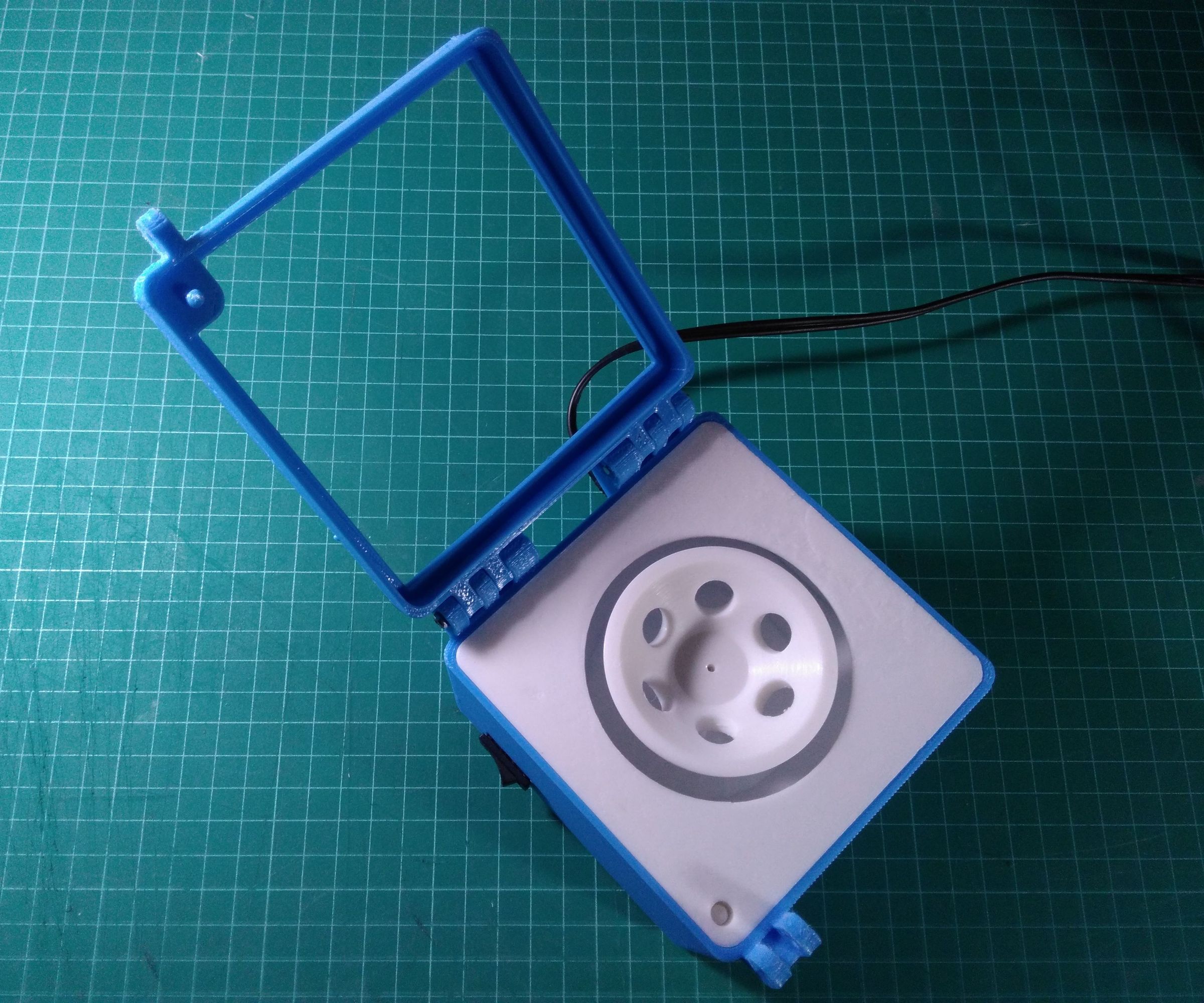

Assembly:
  1. Drone motors come with small, compatible bolts to fasten them to drone fuselages. Use these bolts to attach the drone motor to the motor mount piece. Then use the (4) 14x3 mm bolts + nuts to attach the motor mount piece to the case cover (not the lid).
  2. The drone motor has 3 wires that must be fed through the case cover via an oval hole where they will then be connected to the ESC (see wiring diagram).
  3. It is now possible to wire the rest of the electronics together, using the wiring diagram provided. Be patient and study the diagram carefully. It was made specifically to help non-electrical engineers follow the lines and connect everything literally to where it needs to be.
  4. The rocker switch, once wired up, can be gently forced into the notch on the back, left-side of the case. The female adapter likewise can be gently forced into place after being wired up.
  5. The potentiometer, after being wired up, needs to be attached to the case cover and then fit into place into the space provided for it in the front right-side of the case.
  6. With your Arduino Nano also wired up, you can either tuck it away inside, or you can glue or friction weld a piece of plastic behind it to hold it in place next to the mini-USB terminal hole on the right-side of the case.
  7. This centrifuge is still a "prototype" so carefully pack the wires in and don't worry if it looks like a mess. Just make sure you did not leave exposed wires/contacts out, and that nothing is being pinched or crushed when you place the case cover over the case body.
  8. Once everything is packed in and the cover fits, with the potentiometer in place, you can use the 3 screws, and using the feet as "washers," screw the case cover to the case body.
  9. Next, put the knob onto the potentiometer shaft. You will notice a notch inside the knob. Place a thin piece of cardboard or cut aluminium (be sure not to cut yourself) in this notch which will help it stay on the shaft. The knob should really be removable if ever you want to open the case up again in the future so use caution if gluing -- use hot glue since it is easy to remove without breaking components.
  10. Adding the rotor is done by simply placing it over the motor's shaft and then using the nut to tighten it down. It should be tight, but don't go overboard.
  11. Finally, add the 22x3 mm bolts + compatible nuts to attach the lid on the back of the case, and to use as a fastener in front when transporting the centrifuge.
