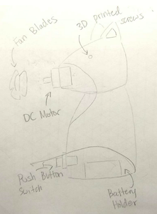

Step 1: Make a Sketch
I started creating the desk fan by drawing a basic design. The final product differed a bit from the sketch. I used sketch as reference when designing parts.

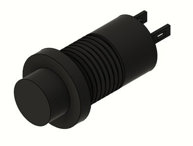

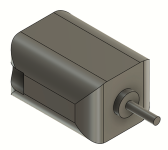

I used Fusion 360 to model the DC motor, switch, and battery holder. When needed, I used dial calipers to take appropriate measurements so that my parts would be accurate.
The models did not need to be very detailed because they were used just as reference when designing parts that needed to be printed. It is very helpful to have parts like this modeled to keep the overall design accurate.

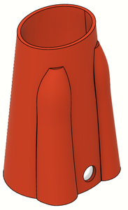

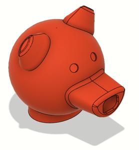

Step 3: Design Parts
Next, I designed the parts for the body of the fan. It was important to take tolerances into account.
Here are my parts:

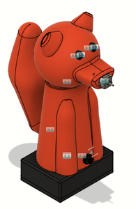

Step 4: Create an Assembly
I created an assembly in order to ensure that the parts would fit together. I had to make several changes to each part file. If I had not made the assembly, I would not have known to redesign until after 3D printing, which would have wasted time and resources.
