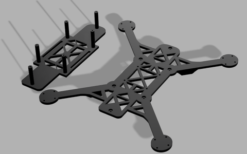

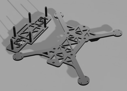

My frame design went through 3 major iterations, with many changes made between prints. All 3 iterations are above in order. The shortcomings of the first 2 designs were really just from me not thinking about certain measurements, so I'd recommend paying particular attention to the length of all wires included with your components and the screw sizes you need.
Design 1: Many of the aspects of the design were copied from typical FPV drone frames, with modifications of course. If you look online for FPV drone frames you'll see many similarities. I stripped away the camera mount from the front made mounting points in the base of the frame for the FC and ESC in the middle, the motors on the arms, and 6 points near the corners to connect the top and bottom of the frame. You will notice extra branches between the main body and the arms of the frame, and there are also feet on the bottoms of the arms, Both of these were added to improve the strength of the frame since it is 3D printed and not as strong as a traditional frame. There are many triangular holes in the frame to reduce weight and printing time. I found that the holes for the screws were too small due to thermal expansion while printing, and after drilling out those holes a bit to confirm that I could fit together the roof and body I widened the holes and reprinted.
Design 2: The only real changes I made were that I widened the holes a little. Unfortunately I found that the motors needed wider screws, which is why I mentioned above to check all measurements. It was also at this stage that I found that the wires for the motors were too short to reach the ESC, so rather than extend the wires I decided I'd just adjust the length and angle of the arms on the next iteration since I'd need to widen the holes anyway.
Design 3: This is the final iteration. At this point the roof of the frame could be mounted by inserting nuts into holes in the standoffs. I had made slots in the arms for mounting the motors instead of just holes because the motors used a 16x19mm mounting pattern meaning, the distance between the holes was not the same across the X and Z axes, and I could easily copy the same frame pattern between the arms if I used slots, with an added side effect being that I could share the design for anyone else to use as long as their motor mounts fell between 16-19mm and it could easily be modified to widen that range. The biggest change that I made, which I mentioned above that I'd have to do, is that I changed the angle and length of the arms of the drone to account for the short motor cables. You may notice that the triangular holes in the frame in this iteration are not the same as in the other two, and that is because the entire frame was redesigned from the ground up, only copying over key elements. When I went to assemble the drone with this frame everything went together perfectly and I decided I could go on to the final print after doing a test flight.
