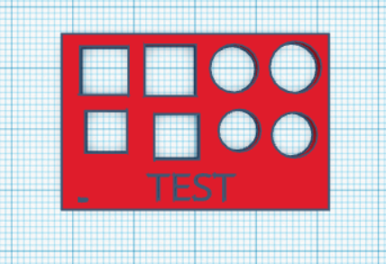

Step 3: 3d Printed Tools for Finding the Circumference
The tool shown above is a 3d printed piece consisting of holes measured to a varying diameters, you can make this for yourself to find the perfect diameter for your drone mount.

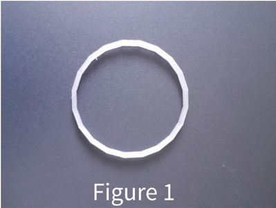

  • (Figure 1)
This was my first 3d print I did for this project, I used it to gain some experience on 3d printing since it was my very first print and also to see if the propeller fits inside it’s space.

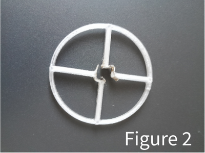

  • (Figure 2)
I added 4 mounting beams to the previous print, which allowed me to actually see if it would mount to the drone. The diameter was too big for the drone, which made the attachment very loose.

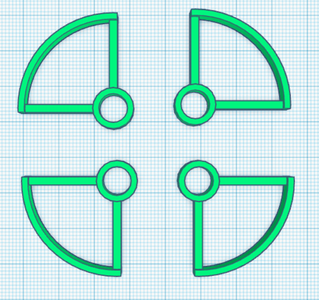

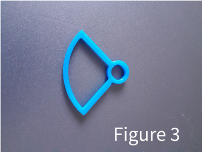

  • (Figure 3)
I decided to make the guard smaller by cutting down the unwanted areas, since it would make the guard lighter. With this design, I was able to find the perfect diameter for the mount.

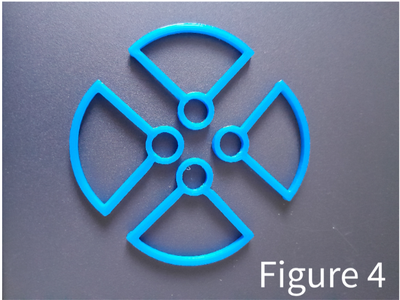

  • (Figure 4)
I make 4 copies of my previous design for the 4 motors of my drone

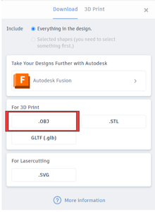

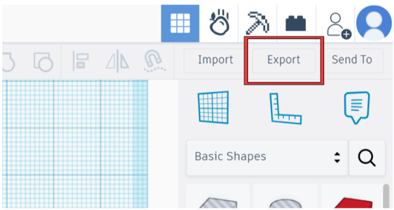

First download your file, I downloaded my files in STL format because it is the most common file format used in 3d printing. You can download your file by pressing the export button on the top right button on Tinkercad.
