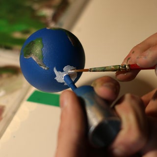

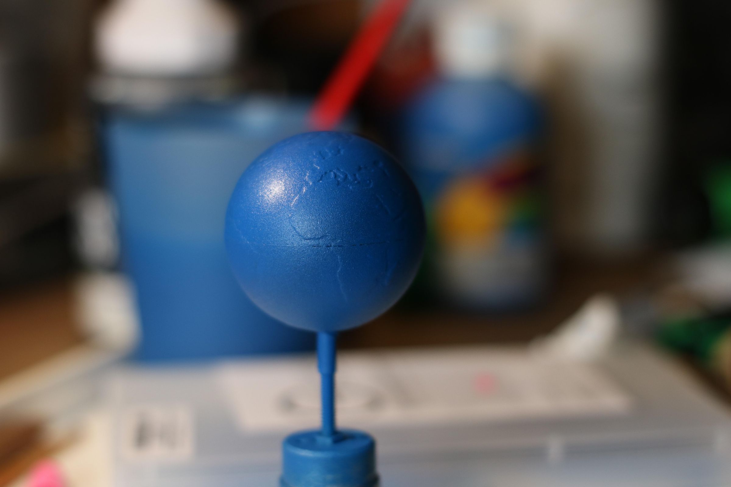

Sand the globe with 120grit and 400grit sandpaper to remove the elephant's foot around the equator and to smooth out the surface, then spray 2 coats of primer and finally sand with super fine sandpaper (I used 800).
_
At this point, you can decide the color of your Earth: green and blue, black and white… or “realist” like mine.
To achieve a realistic look, spray blue paint over the entire globe, and paint the continents with acrylic paint according to the colors on google earth.
_

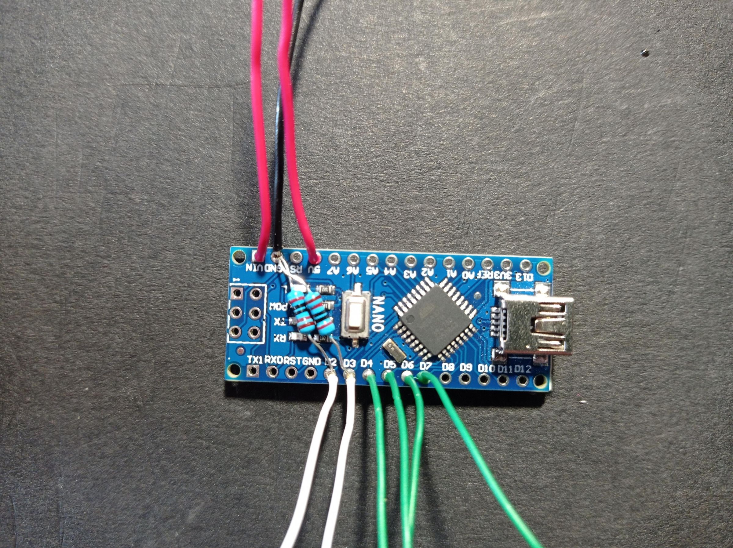

You can see here what you will need for the following schematic (wires are ~5cm long).
I started by soldering the two resistors and the wires on the Arduino
_
Then, I soldered these wires to the other components (buttons, ULN2003 board)
Finally, I soldered the USB cable to the ULN2003, but first, don’t forget to pass the cable through the 3D printed piece [2] !

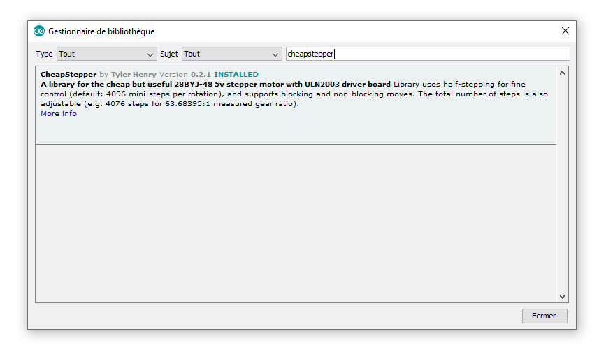

You need to install a library: CheapStepper by Tyler Henry
Here is the code:
