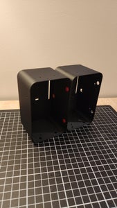

Step 1: Plan Out Your Displays
Before you rush into soldering and printing parts, you need to plan out your display(s). This will determine the lengths of cables and 'types' of digits you need to make. As you can see in the images above, there are 3 types of digits:
- Standalone/Solo digit (Wires connected to both in & out) - Not shown
- Left & Right end digits (A digit that is next to one other, thus has wires connecting to either in or out)
- Middle digit (A digit that has another digit on both sides, thus has no wires connecting to it)
The type of digit only changes the type of case you print, and the additional header pins needed. Digits that are next to each other are connected with a joiner PCB which I will touch on shortly, digits that are separated by a gap need to be connected with cables, and the first digit that connects back to the main controller needs to be connected with a cable.

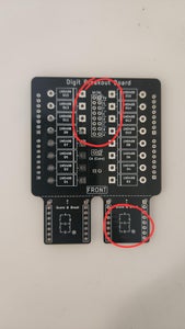

Step 12: Make the Digit Joiner PCBs
To make the digit joiner PCBs you first need to use a sharp knife to score both the top and bottom sides just below the dotted line (located on the base of the digit break-out board). Try to score as close to the first terminal as possible, if you score directly on the dotted line, you will have to sand them down later. Then gently break them away by clamping them along the scored line to a hard surface and pushing downwards. Then take four 8-long straight male header pins, and solder them in place (so that the text saying "Black Connector" and "White Connector" faces away from the male header pins).
Step 13: Solder the Digit PCBs
After breaking off the digit joiner PCBs (or leaving them attached if you do not need to use them), we can now proceed to solder the remaining components onto the digit break-out boards. Cut and solder all fourteen 1N5408 diodes into their respective positions (leaving the bottom two empty), paying close attention to polarity (indicated by the white stripe). Then solder all fourteen 1N4004 diodes with the white stripe facing downwards (into the PCB) into the 2x8 connection pads (leaving the top two empty). You can then trim the top side of the diodes so that they are the same length as a standard male header pin. You will see in some images I have soldered a resister and additional wires on the PCB, this was due to a design oversight and the PCBs that you ordered do not have this issue. You will however need to solder a 10K resistor in its respective position (that is not shown on my outdated boards).

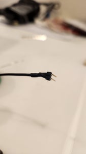

Then solder a 1x2 male 90 Deg. header to the common anode (CA) connection as shown (pointing downwards), as well as one 1x2 female header to the common anode input. Depending on the 'type' of digit you are making, will determine if you solder male or female headers to the four 1x8 way rows on the back of the PCB. Female headers should be where a digit is adjacent to another (and will have a smaller slot in the case) and male headers should be where a digit is going to have a cable connected to it (and will have a wider slot in the case).
At this stage, you can check both digit joiners fit by pushing them into the female headers (either the in/out ones - depending on the type of digit you are making). If they don't both sit flush (one overlaps the other) you will need to sand them down until they do. You should wear a mask when sanding fibreglass PCBs to protect your lungs, as well as other PPE such as gloves and eyeglasses. If you find they don't sit flush, try to cut them closer to the solder pads on the next digit (if you are making multiple). This was a design oversight that I will talk about how to improve in the final steps.

Now that the PCB has been soldered, and the coils have been wound, it is time to finish the digit assembly! First, take the digit case, and push in both PCB clips into the rectangle slots (such that the one with additional alignment tabs is at the top, and the tabs are facing upwards). These clips should be a tight fit, and if not, you can add some glue (after checking you can clip in the PCB). If you are unable to push the PCB into the clips, you can remove the clips, push them onto the PCB, and then install both clips and PCB into the case at the same time. The PCB will need a bit of extra force to push the female headers through the slots on the back, so be gentle and take your time.
After that, align the centre panel so that the top of the case lines up with the top of the centre panel. You will then need to plug the cathodes and anodes into their respective positions on the PCB (make sure you get the cathodes in the correct order so that A, B, C... and Wt & Bk line up with the markings on the PCB). You can then push the centre panel into the case until it snaps into place. Make sure all the 8 tabs have located themselves into the small rectangular holes on the side of the case. You can then install all 7 flaps, making sure they can rotate freely and are orientated correctly. Then push in both front filler panels, by aligning the middle cut-out to the middle of the digit, and pushing them onto the hexagonal posts of the centre panel. Finally, lock everything in place by installing the front outer trim. Once again, check all flaps can rotate freely. If they cannot, try cutting/sanding a very small amount of both ends of the "nubs" that jut out of them. Even if they could rotate freely before, the front outer trim will pull the posts closer together (locking in the flaps) so you should check all flaps again by hand. If you need to remove a flap, you will first need to remove the front outer trim.
If you are making multiple digits and you want to join them together later, insert the 3 hex joiners before anything else into the side of the two cases. These can be a bit fiddley, and if they don't clip into place, try scaling them down and printing them again.
Optionally you can add feet to the digits by pushing them into the circular holes on the bottom of each digit.

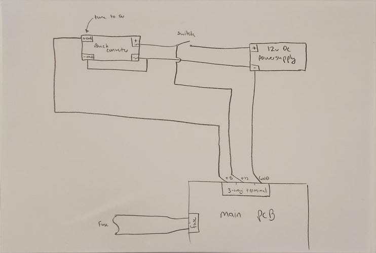

Step 18: Solder the Electronics Box
The main PCB requires 5V and 12V DC to be supplied in the screw terminals as written on the PCB. This means you can directly run a 12V cable into the electronics case, through the switch and then into both the PCB and a buck converter. You must use a multimeter and the adjustable trimpot on the buck converter to step down the 12V to 5V which can then be wired into the PCB. Follow the wiring diagram as shown below;
Make sure you push the switch into the front panel before you solder wires to it. To mount both the PCB and buck converter, push them onto the raised tabs as seen in the images above, and then use two small M3 Screws (one for each PCB) to hold them in place. You will also need to solder a fuse to bridge the two solder pads labelled "fuse" on the main PCB, right of the ESP.
There are two rows of "extra pins" which means if you have other projects or functionalities you want to add (for example a speaker, as shown in one of the images) you can easily do so. Similarly, there are solder pads for 3.3V, 5V, 12V and GND, should you need them.
Step 19: Assemble the Electronics Box
To assemble the electronics box, simply slide the lid into the right-hand side, then use two M3 screws in the top and bottom left-hand corners. If you want to redesign this box to use 4 screws you can, I was trying something new and still need to work on the slide-in design. You can see some other improvements I'd make in one of the final steps.
