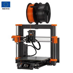

  2. 3D Printer

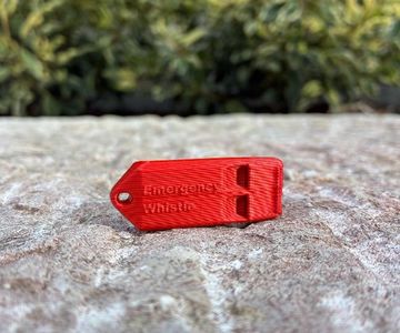

The STL file for the final whistle I designed can be found here: Whistles
Step 20: Testing
Although I didn't get to print my latest version before a trip (due to my printer being broken), I did manage to test V4 and V5 out in nature. They both performed extremely well and could be heard in the woods from at least 350 meters away. My mother reported hearing the higher pitched sound (from V4) better than the lower pitched on in V5. This matches my observations and tests (V5 is indeed quieter than V4). However lower pitched sounds should penetrate objects better. My final emergency whistle combines both of these whistles to get the best of both worlds.
After the trip I fixed my printer and printed the latest design. This one worked as expected and the created dual tone design made it difficult to ignore. I measured the loudness and pitch and got 126dB up close and 120dB from one meter away. (Take this measurement with a pinch of salt because I'm not sure the website accurately records loudness) The pitch was around 2.3kHz and 2.6kHz combined, each with their respective overtones and timbre.
