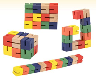

My friend in 3rd grade had this fidget toy that was made up of 12 cubes, all connected by a stretchy string. The toy could be pulled apart a small bit, then it would snap back together with the faces touching. I thought this was cool and wanted to see if I could 3D print something similar.

In the reference image, each cube has a slit cut into the faces, each going about halfway through. I assume it goes slightly more than halfway, however, so that the cord has a hole to go through. The cord that I have has a thickness of 1mm, so I want to make the center hole about 2mm. Now, I just have to decide the remaining proportions. The Amazon page for the one I am basing this off has a review containing a picture of somebody holding one. Google says the average palm size is 3in, and about 4 cubes take up the length of the palm. 3in divided by 4 cubes is .75in per cube. .75in is about 2cm, so I'll just go with that. To make the hole in the center 2mm, I need the slits in the cube to be 1mm over halfway, so that combined, would form a hole of 2mm cubed. The stretchy paracord will then go through all the cubes, then tied with a knot at the ends. After starting printing, I found that the cubes were about 1.5 times the size I wanted, so the revised size is a 15mm cube. Even this seemed a tad bit large, so I shaved 2mm off all sides, leaving a 13mm cube. After I printed these, I needed to tie the rope multiple times to prevent from slipping through, so I narrowed the slits down from 2mm to 1mm wide.
