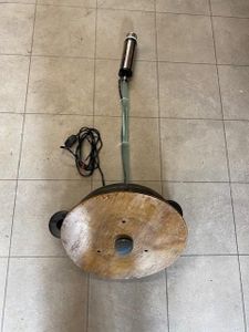

Step 2: Floating Raft
I wanted the fountain to float in the middle of the pond to I decided to make a floating raft to carry the pump and nozzle. I wanted to use recycle materials as much as possible for this project so I made the floating raft out of the flange from an old cable drum and an old wheel barrow inner tube to provide the floatation.
I first sanded down the old cable drum flange and coated it with yacht vanish to prevent water damage. I left the varnish to dry over night.
Next I mounted six 25mm cable tie bases to the flange. Although these are self-adhesive I screwed them on as eventually they would come unstuck.
Finally I pumped up the innertube just enough so it would keep its shape and mounted it to the base with long cable (zip) ties

I first assembled the pump and raft assembly as follows:
- Connect the 20mm diameter 500mm long tube to the pump outlet and secure with a hose clip.
- Pass the other end of the hose through the centre of the raft and slide a hose clip onto the hose.
- Connect the hose to the nozzle inlet.
- Tighten the hose clips.
- Secure the nozzle to the raft with 2-part epoxy glue and allow to set.
