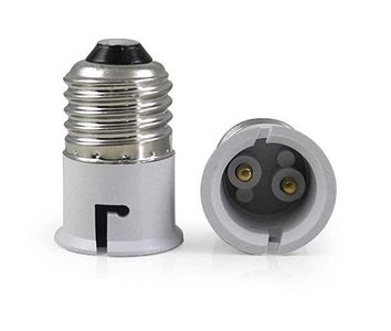

5> LED Bulb and holder(any color)(Filament LED bulb or WHITE LED bulb)
6> wires and Plug

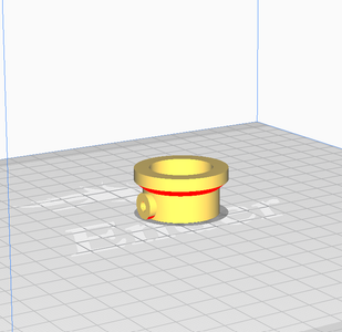

1> Center part for Bulb Placement
2> Leaves
3> pole
4> Tri-leg Base

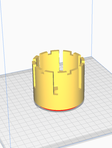

I started with the Center part, Inner diameter is 30 mm and the outer diameter is 85mm.(consider your holder and bulb diameter.)
Offset the outer edge to 5mm inside to make a small circle.
  • Extrude the circle region to the 5mm bottom side.
  • Extrude the same sketch outer circles to 65 mm upside to make a circular wall.
  • Make 6 square gaps for bigger leaves and 6 shallow gaps for small leaves.

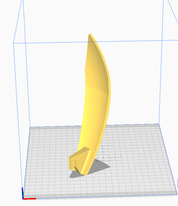

  • Then design a bigger leaf that is offset 20 mm from the circular part.
  • Use the Circular pattern command for 6 big leaves attached to the center part.
  • Design a small leaf and use a circular pattern command for 6 smaller leaves.
  • Attach small and big leaves inappropriate gaps.
  • Design pole attachment with screw hole to make it rigid.
Design a wooden pole as per your hardware available.
  • Extend the pole at approx 700 mm.
  • I made tri-poles as a standing base for the lamp.
  • Design 1 pole to 3 pole connector.
  • Make an appropriate hole for the screw.
