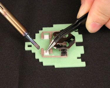

Step 8: Carefully Smush the Electrifi Filament From the Pads Down Onto the Metal Leads of the LED While Pushing Down Onto the LED With Tweezers.
Use a soldering iron to smush the Electrifi filament from the pads down onto the metal leads of the LEDs. In this case, a flat tip of the soldering iron works better than a needle shape. Try to smush the Electrifi relatively quickly and only so much as to cover the metal leads of the LED. Be careful not to create a short circuit between the two Electrifi pads by smushing them together.
Step 9: Insert a Coin Cell Battery Into the Battery Holder.
Slide the coin cell from the top and with the positive side facing toward you. The conductivity of the traces is poor while it is still hot. So, let it cool down completely and you will see the LEDs light up.
