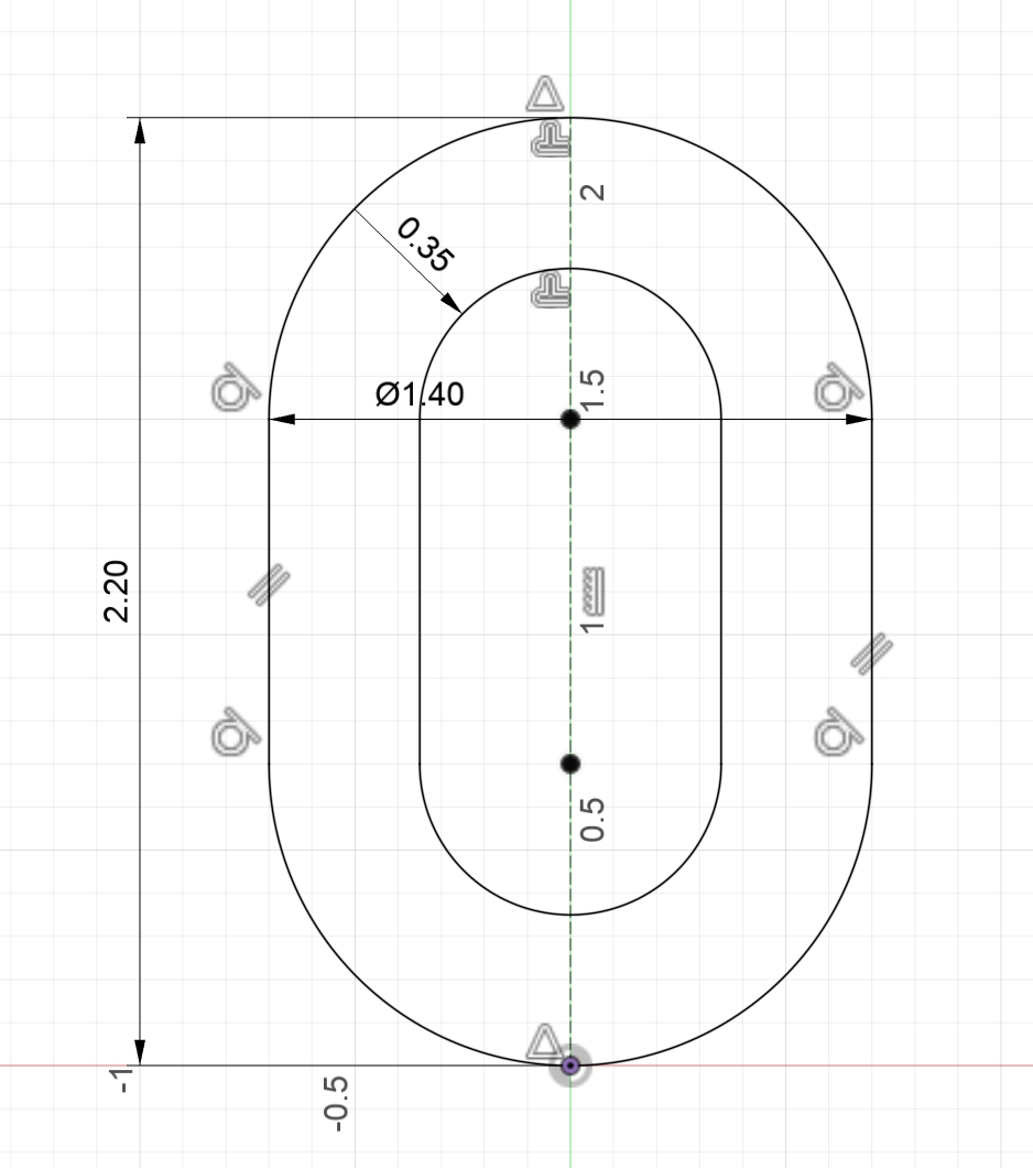

Next, using my sketches as a guide, I translated my design into Fusion 360. For this, I was able to mimic the intended design language and sketch out a similar shape for me to extrude. For more complex shapes, I would usually import a scanned image of my sketch directly into Fusion 360 and use it as a tracing template—this would make it easier to match curves and proportions accurately.

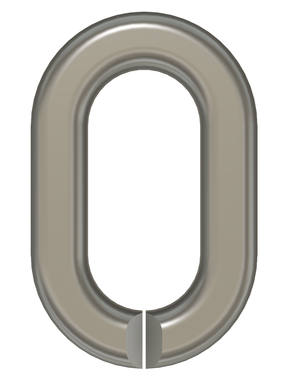

It’s important to design a simple and secure way for the links to connect. I added a small slit with a chamfer on one end of each chain link, allowing two links to snap together with minimal bending. Because the slot only appears on one side of each link, once assembled, no two slots ever need to align directly. This helps prevent weak points and reduces the risk of the chain pulling apart under tension.
Another one of my design choices involved print orientation. I knew I wanted each chain link to lay flat on the print bed. To avoid creating large overhangs, I added one large main fillet on the top of the chain and a smaller fillet on the bottom. This allowed the link to print cleanly without supports while still keeping the rounded look I was going for. Once thew chain is being worn, this difference will be hardly noticeable.
For me, the hardest part for me was determining the right size for each chain link. It took some trial and error to find a scale that felt oversized enough to make a statement while still being practical enough to quickly print.
