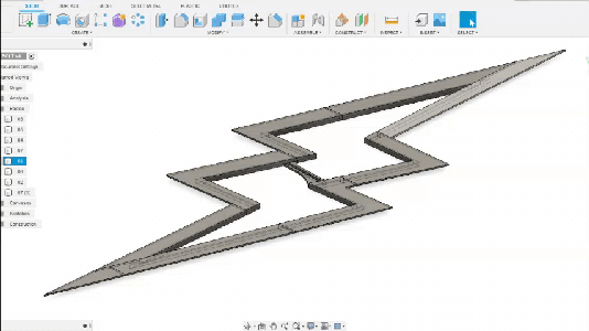

Step 1: Design and Planning
In order to get started, I first have to search for an image of a lightning bolt that I will trace in Fusion360 to make the basic shape.
  • In Fusion360, I uploaded the image of a lightning bolt and calibrated its size so it would be 500mm long.
  • After that, I modeled the bolt by tracing the image and the end result was a huge lighting bolt logo that is ready to be 3D Printed.

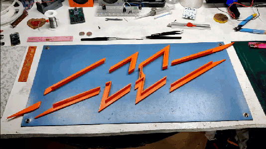

Step 2: 3D Printing Process

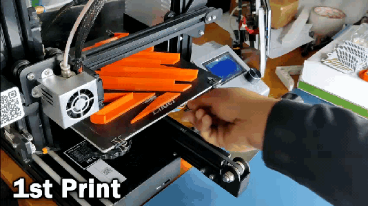

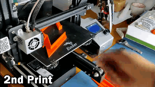

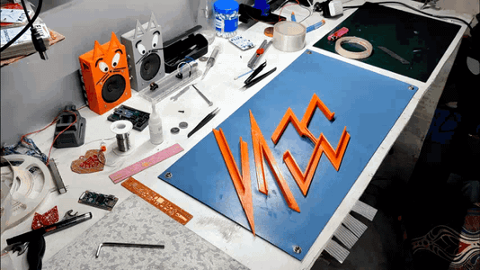

Now here's a slight problem, I only have an Ender 3 whose built area is 235mm x 235 mm but my model is 500m Long.
To print the model on my ender 3, I cut down the model into seven pieces and printed all of them with these below settings by using orange PLA.
  • Nozzle size- 0.8mm
  • Layer height- 0.32mm
  • Supports- YES
  • Infill- 30%
Printing all the parts took two cycles as in the first cycle, the built plate was completely filled.

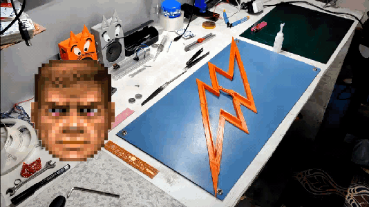

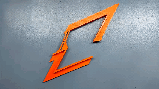

Step 3: Attaching the 3D Printed Parts Together #1

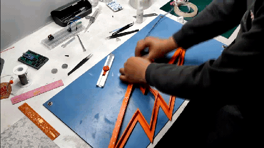

After 3D Printing all the parts, I then align all the parts according to their right place and started the super gluing process which involves me using a plastic quick adhesive to permanently attach all the PC together.
Now, because there were so many pcs, I joined all the parts in 3 different parts first.
Step 4: Attaching the 3D Printed Parts Together #2

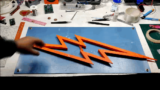

I then connected the previously attached Pcs together to make a single unit with help of super glue.
PS- I also used fiber tape to hold down two parts while the glue solidifies, it helps a lot in keeping all the 3D Printed parts intact and sturdy. Then End result will be a Huge Lighting Bolt made completely out of PLA. Now let's add LEDs to it and make it glow.

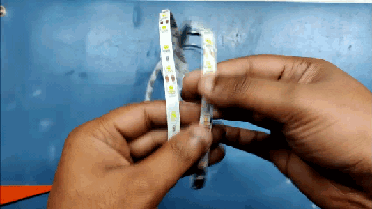

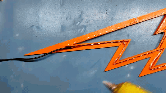

Step 5: Adding Light Strip

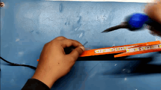

To Make things glow, the best way is to add LED strips onto them.
I've made the bolt in such a way that the Bottom side has a wall all over the Bolt shape, we can attach an LED strip onto this wall.
I haven't used any LED Driver or Microcontroller based Circuit in this project, I could use a circuit that fades or control the LED in any way but I didnt because of keeping this project simple and easy to make.
Here's one suggestion, we can use LEDs that are controlled by a remote control like those fancy RGB Strips that comes with remote control.
I didnt have those so I use a white LED strip instead.
Step 6: Power Source
As for the power source, I'm using a generic 12V SMPS adaptor which isn't really a 12V Adaptor as its output voltage is around 15V but it will work just fine with the LED Strip.
Step 7: Finalizing
I added positive and negative wires of the adaptor directly with the LED Strip VCC and GND.
I then added hot glue to hold the wire in its place and secure the solder joints.

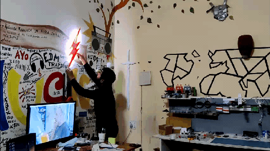

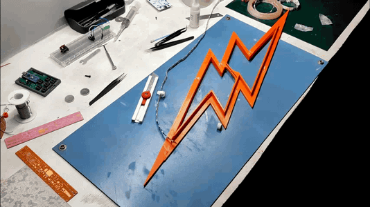

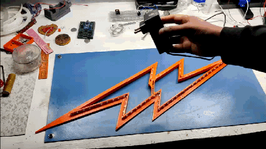

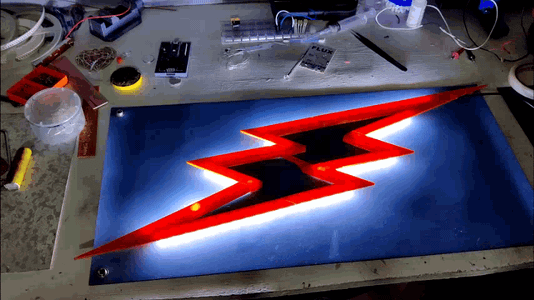

Step 8: Result
Here's the result of this short-built, a Huge 3D Printed FLASH Logo made which also serves as a night lamp.
