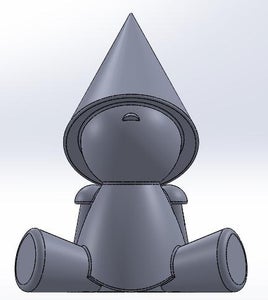

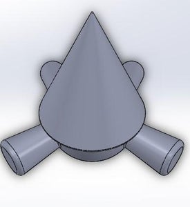

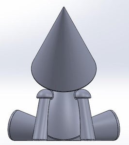

We modeled our gnome in the CAD software of our laptop we used in university: SolidWorks. It can be made with any CAD software available and there are more suitable. In this case we managed with this one because we are used to it.
We needed to specify the geometry of the different parts and identify the main bodies of our gnome:
  • Hat
  • Hea
  • Body
  • Shoulders
  • Arms
  • Legs
After having defined the main bodies, we did one sketch - one body  design. With this methodology we found it very easy to define the gnome shape.
WARNING: We were supposed to build our gnome by 3D Printing it. In order to avoid manufacturing problems, we avoided any sharp endings and cantilever design.
