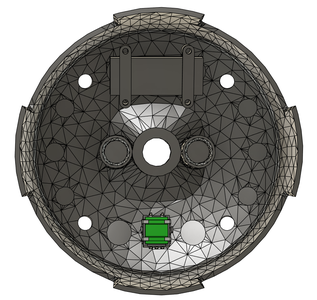

The original CAD files were modified to have 4 equally spaced holes for LEDs, a hole for a rotary encoder, and a larger hole for a display. The LED and rotary encoder holes were straightforward, but the display needed provisions for mounting. Four posts were introduced and brackets were added so that screws could hold the display solidly in place.

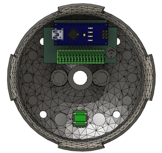

Step 3: Printed Circuit Board Design
Because of the small space inside the housing and the additional components compared to previous mine projects, the only way to get everything to fit was to use a printed circuit board. I laid out the circuit board in KiCad with a few key features.
First, I chose a 4-layer board to keep the form factor small without unnecessarily complex routing of traces.
Second, the display could be soldered to the board after it was fastened into the plastic housing.
Third, the Arduino Nano could be plugged into a socket. The socket allowed for soldering access to the display through holes.
Last, I wanted a connector block that all the wiring for the LEDs, rotary encoder, and power could easily plug into.
