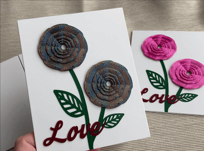

Valentine Card with Flower

Step 3: Front
The easiest part of the card to design is the front. That is going to be on top of the right rectangle.
To make sure your design is where you want it, you can put your Workplane right on top of it.
Then, go to town!
For the flower/love one, I broke up the design into layers so I'd be able to at least print the top of the card by changing color between layers instead of having it change more often between shapes.

Export your design by color. So, for the flower Valentines card, it would be the Card, Inside Words + Love, Stem, and Flowers. [I'm showing them all separated so you can see, but make sure you export them while they are in the orientation you are printing so they line back up in the slicer.

Step 11: Finished Valentine Card With Flowers
Enjoy your cards!
