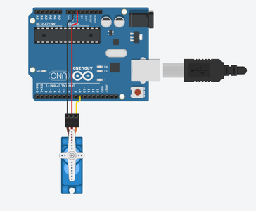

Step 23: Wiring Diagram
1st image is wiring for voice response feature. 2nd is wiring for face tracking. The blue servos are mg90s and the black servos are Mg996r servos. Be careful with the wiring. The power supply in the image is the Zebronics SMPS. refer to the code for more details on the wiring. For the power supply to work, locate the 5v and 12v output wires using a multimeter and connect them to the Arduinos and servos as shown in the above diagram.
