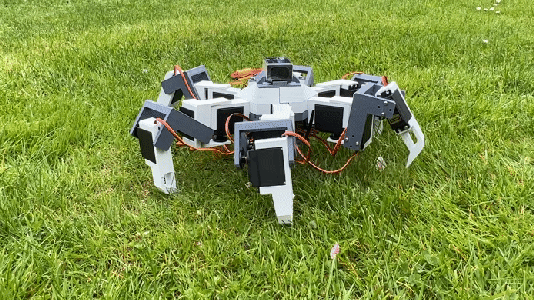

Introduction: 3D Printed Hexapod Robot
A hexapod is a type of robot with 6 legs that can move independently, which makes them good at moving across different types of terrain. Now a few months ago I came up with the idea of making my own hexapod just for fun. So in this project I show the design and assembly of a fully 3D printed, arduino based hexapod.

Step 2: 3D Printing
For this project all of the mechanical parts are 3D printed. Most of them can be printed using PLA with standard settings and minimal supports.
A leg is made from these parts: leg_mount.stl, coxa.stl, femur.stl, tibia.stl, which will need to be printed 6 times in total.
The rest of the parts make up the base of the robot and only need to be printed once, with mounting_post.stl being the only exception as two copies of this are needed.
⚠️ I would recommend printing a single leg and assembling it first to check that everything fits together correctly.

Step 11: Hexapod Gait Code
The last step is to upload the code hexapod.ino onto the arduino. In the code there are functions that implement a simple ripple walking gait for the hexapod.
Quick explanation of the code:
- Each leg goes through two phases: the swing phase and the stance phase.
- Swing Phase: The leg is lifted and moved forward.
- Stance Phase: The leg is on the ground, pushing the body forward.
- The legs move in a ripple pattern to ensure the hexapod remains stable.
- No more than two legs are lifted from the ground at a time
