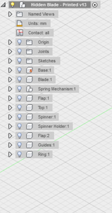

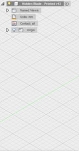

Step 1: Design Process
The first step after starting a new design file was to create separate components for each of the pieces needed for the hidden blade prop. This populates the design tree with several expandable folders.

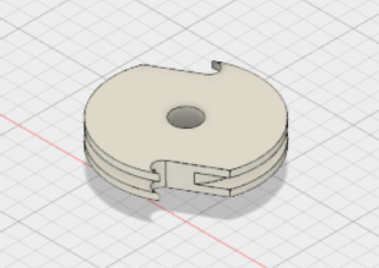

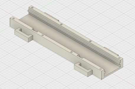

Step 2: Sketching and Modeling
After the initial design tree was constructed each component was sketched up and modelled. This process involves creating a 2D sketch and then "Extruding" it to create a 3D object with a matching profile. The 3D object can then be modified by stretching the faces or making sketches on the faces and extruding either positively or negatively. A hole would be made by sketching a circle on the face of an object and negatively extruding into the object. A shaft would be made by sketching a circle on the face of an object and positively extruding away from it.
NOTE: There is a .GIF in the first image frame but it doesn't seem to be working in the "Full Preview" window. I apologize and will attempt to include an alternative form of instruction ASAP.

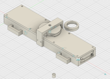

Step 3: Assembly
Once components have been modeled, they can be re-positioned using the "Move" and "Align" tools. They can be connected to each other using static or moving "Joints". It is important to consider the order in which joints are created and what the dependencies are between each of the joints and objects. It is possible to create a joint constraint that is impossible to complete. If two objects have a static joint that prevents them from moving relative to each-other, it is not possible to later on create a joint that requires one of the objects to move while the other remains stationary.
NOTE: I am having the same issue with the .GIF file for this step as well.

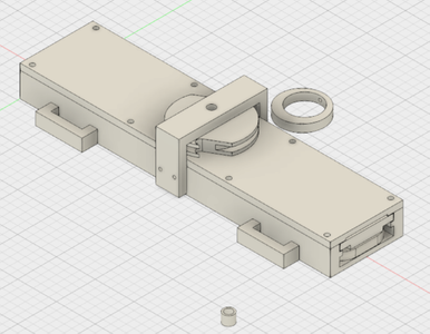

Step 4: Motion Testing
It is possible to create physical interactions between components in an assembly. This means if one component is moved, it will move the other components that are connected to it, creating a simulation of the mechanisms' movement.
