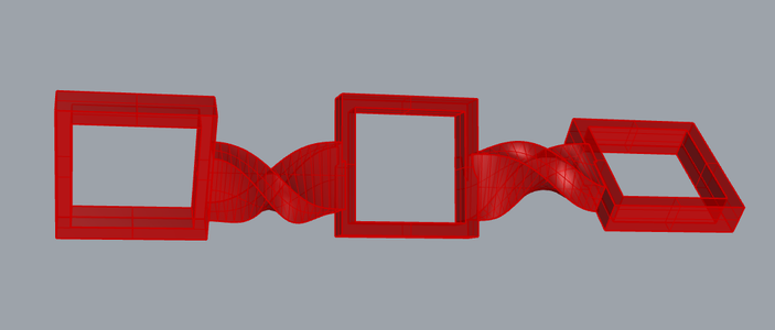

Step 1: Sketching Ideas and Modeling in Rhino
Coming up with a good idea was as usual complicated and took the most time. When I found a general direction, that is, I knew I wanted to create something that would have sharp angles yet organic/ smoother looking connections, I moved to 3D modeling in Rhino.
Initially, I started my modeling process using SubD tools but since my main idea contained sharp, angular shapes, this was much harder to do. Everything I tried to create in SubD ended up being an extension to my sketching process.
Using Rhino's standard tools I made the model that served as the final 3D printed joint. To make the more organic looking connections I used the transform > twist tool. This took a number of trial and errors until I found a curve I was satisfied with.
