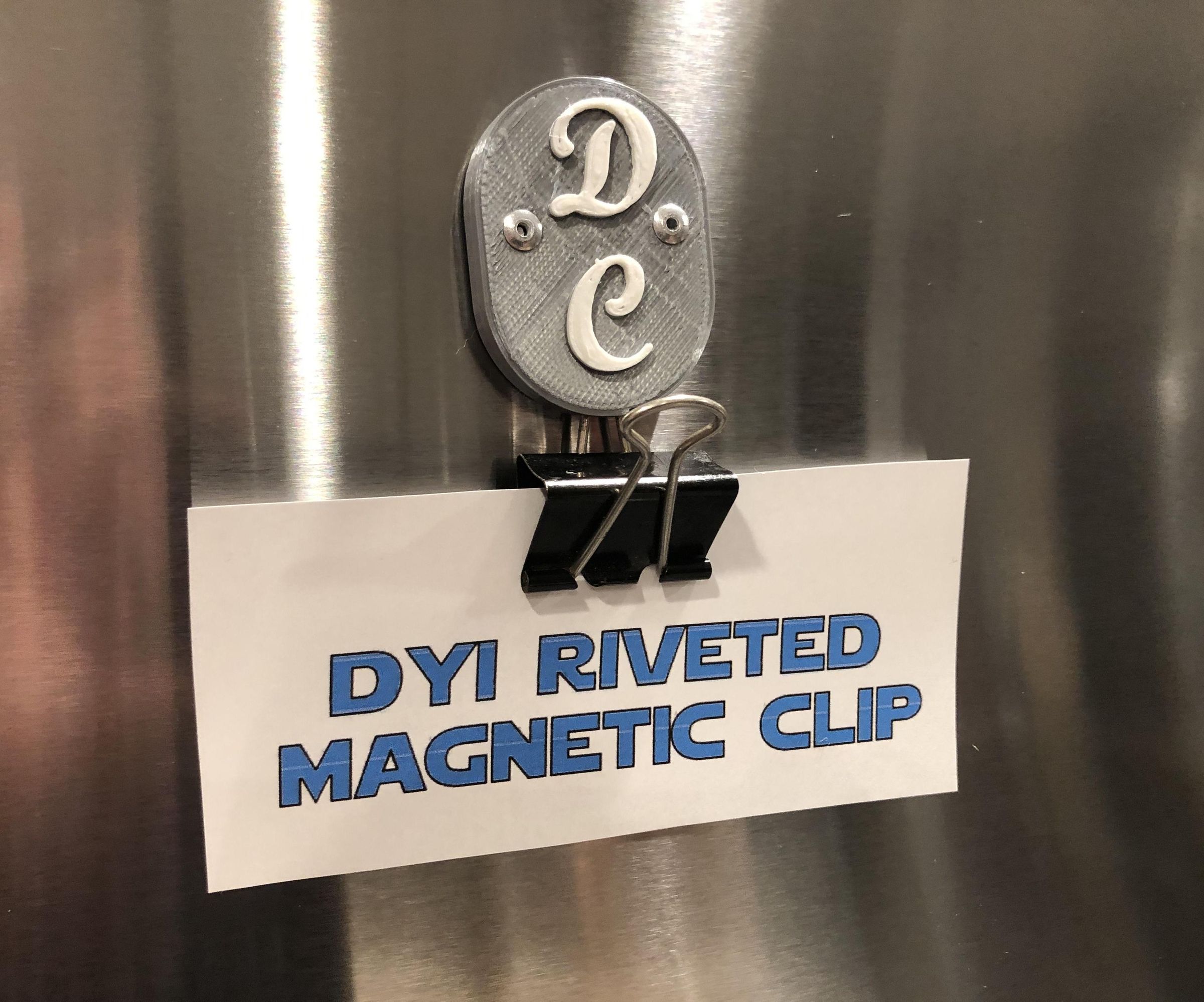

I started by making magnets for the refrigerator. I removed the loops for the ribbon and added some recesses on the back of each design in Tinkercad. I attached THESE magnets using Loctite superglue.
My kids were very surprised when they eventually found them on our crowded fridge.
