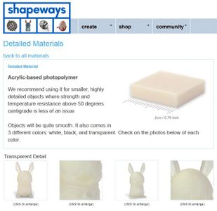

The next thing I needed to think about was the size of the model, relative to how much I wanted to spend for this project. To work that out, I needed to have information about the material(s) to print the final model in.
(Page with details for all the materials at shapeways - http://www.shapeways.com/materials)

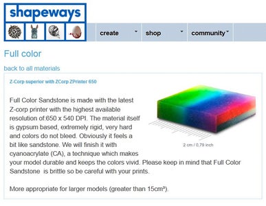

Since I didnt want to paint the models once they were printed (or any additional post-production work for that matter) I decided that the 'Full Colour Sandstone' was a good option. Its an easy choice to make, since theres no other material at this stage which prints full colour models.
For the visor things are a bit trickier, and it took a few test prints before I found the right material. I wanted something transparent (preferably plastic) so the visor is see-though enough to see the Kerbals face behind it.
I ended up choosing the 'Transparent Detail' material, its not perfect, but its the best material Shapeways had to offer for this.
Full Colour Sandstone (FCS) material page for more info - http://www.shapeways.com/materials/fullcolor
Transparent Detail (TD) material page for more info - http://www.shapeways.com/materials/white_detail

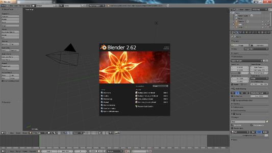

The next step is to model the Kerbal character, I used Blender (an opensource program you can download for free directly from www.blender.org) but any 3D modelling program should do (as long as it can export the finished model to a useable format for 3D printing and supports UV texturing - I'll get to that soon)
I'm not going to go into much detail here about the actual process, 3D modelling is something which can take a long time to learn and theres plenty of tutorials and learning resources out there on the internet which will cover the topics better than I can here.
The modelling took several days to complete and tweak until I was happy with the result and was confident the model was weighted properly, so it would stand up without falling over.

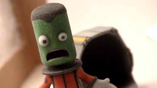

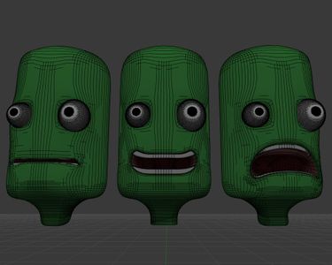

It was also important to model 3 different expressions (for Bill, Jeb and Bob) as I wanted 3 unique Kerbal models.
I finished by adding some basic colouring to the model, which is to be later used for the final texturing stage.

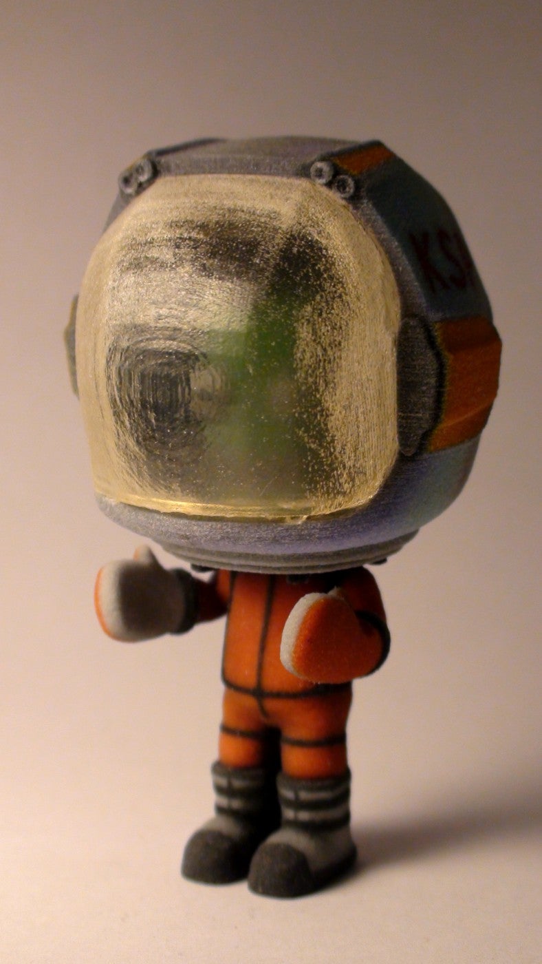

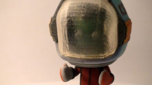

I should also note that I experimented with several different materials and thicknesses for the visor.
The first visor was printed in Frosted Detail but ended up not being very foggy, and no where near as transparent enough as I needed. Another test print was super thin in the Transparent Detail material I ended up using, but was printed deformed because the walls were so thin. It can take several attempts to get a object right when printing out materials your not familiar with, or objects that are very small - in this case both.
To make it fit the helmet I simply duplicated the entire inside 'lip' of the helmet, including the holes, and extruded the rest of the visor from that.
This meant the visor was a perfect fit for the helmet, with the usual tweaks here and there.

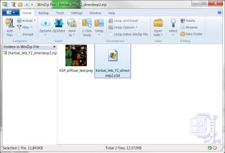

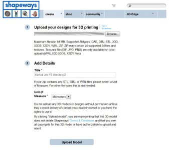

I chose to use the .x3d format (one of the suggested ones on the Shapeways uploader for coloured model exporting). This format preserves UV's and textures, which is exactly what I needed.
From here I could send the model straight to Shapeways to be printed, but it would probably fail during the automated checking. Theres one thing left to adjust - the size of the model.

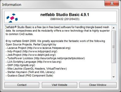

This is something Blender isnt the best for, so I downloaded Netfabb and imported the model. This can also be done using MeshLab.
Shapeways has a good tutorial for using both of these programs to prepare a 3D print here - http://www.shapeways.com/tutorials/how_to_use_meshlab_and_netfabb
Once the model is imported into netfabb the dimensions get set to a real world scale, in this case I'm choosing to work in 'mm'. Netfabb also has some useful tools for analyzing a model and will tell you the exact volume of material the model will use when its printed. This is very handy when your dealing with the prices of 3D printing materials (per cm^3), since you can use these numbers to determine the price of the model before its even uploaded to Shapeways. Netfabb also has tools for fixing meshes, displaying any inverted normals and other problems which may arise.
The model was then re-sized using Netfabb, and finally exported to a similar format (.x3db). The final step before uploading is to put the .x3db mesh in a .zip along with the texture (either a .jpg or .png). Then its off to shapeways to upload and order!
~2 weeks later the prints have been produced, shipped and arrive (shipping takes a while to get to us Aussies)
