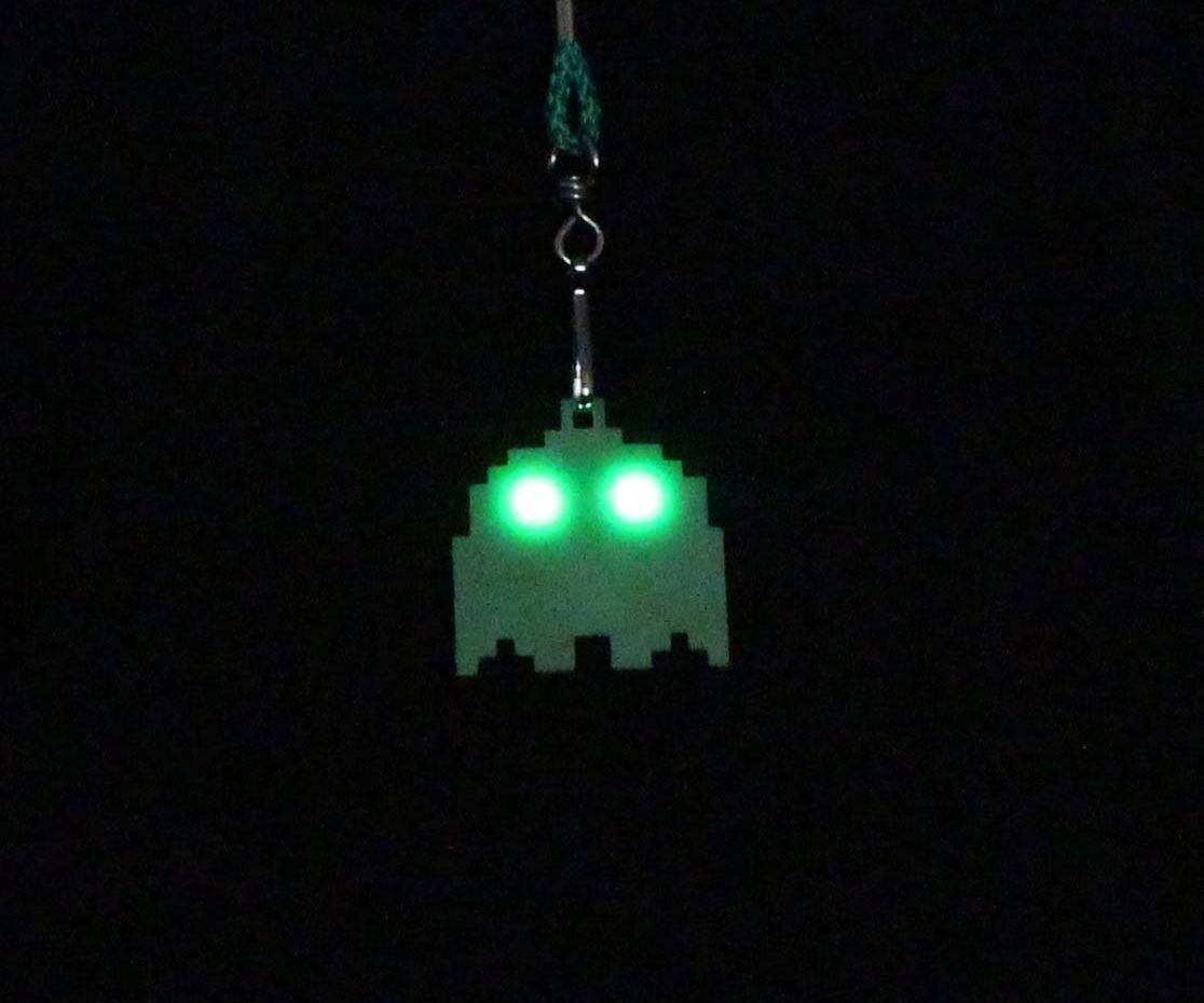

Introduction: 3D Printed LED Nametag
This tutorial will demonstrate how to make a 3D printed LED nametag with Electrifi conductive 3D printing filament. If you don't want to go through the process of designing the circuit yourself, you can skip ahead to printing the nametag in step 5. I'm including the process of designing the circuit in this tutorial so that you have the tools necessary to customize the LED nametag in any way you desire.

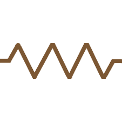

The nametag schematic consists of two component types: (1) light emitting diodes (LEDs) and (2) pads for connecting the wires to the battery. Most LED circuits also require a resistor, but here we're relying on the filament to provide enough resistance to limit the current to the LEDs. The schematic shows how these components, represented by symbols, are wired together. However, when you place components in EAGLE, you are placing a 'device' which consists of both the schematic symbol and footprint, i.e., the areas of copper (or in this case the areas of Electrifi filament) that will be available for connecting to the device. If this isn't clear now, it should become clear later on.

Step 5: Print the Nametag
Now its time to print your nametag.stl file. If you have not done so already, check out how the instructable on printing with electrifi filament. There you'll find the stl file for a 0.5-mm-thick nametag as well as the Cura profile used to print the filament. Note that the last video showed a 1-mm-thick nametag, but I actually print the filament 0.5-mm-thick since its faster and avoids shorts between the LED pads. The .stl file for the nametag circuit is available for download here: led_nametag.zip. I printed the circuit with Electrifi Filament on foam board.

Step 7: Finishing the LED Nametag
To finish the LED nametag, you can use tape to attached the battery to the back, and add a pin. Now its ready to wear! Feel free to customize the design to make the nametag bigger or smaller, or change the circuit layout to have different patterns of LEDs. You can also use a piece of paper to diffuse the light from the LEDs. By combining printed messages on paper with the lights from the LEDs, you could get a lot of different effects.
